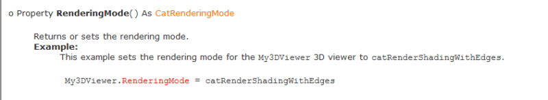

Have a look to Rendering mode property:
Regards
Marc

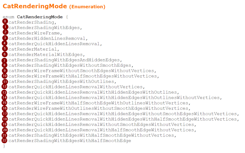

I've checked the RenderingMode method and realised it is limited to 23 predefined values. When I set my customized settings manually (pic4) and then use RenderingMode to retrieve the value I'm looking for, it returns number 9. Obviously number 9 is not what I was looking for. I guess this means I have to settle for using three predefined modes:
1 for normal work,
8 for checking sharp edges,
5 for checking undercuts.
I prepared a macro toggling me between theese three modes. You can find the code below. Works fine for me.
