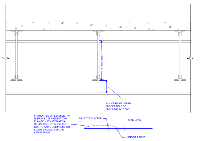

Hi all,
I am currently working on a retrofit to a 50 year old steel building. After performing design calculations on an ex. W410x60 beam that has a laterally unsupported bottom flange, I realized it fails in negative bending. It is 2 span continuous with an 8 m and 6 m span. The condition is tricking since the intermediate support is a hanger which goes up to the floor above. I have proposed a detail bracing the beam at the hanger support which effectively restrains the bottom flange but because of existing mechanical, we are having difficulties bracing the bottom flange near the inflection points, but bracing can be achieved by extending the OWSJ bottom chord to the web of the W410. This bottom chord extension would brace 75% of the beam depth. Would this be considered enough to restrain the beam against twist if the bottom chords are extended on both sides of the web? I'd also be concerned about bottom flange buckling in plan since the bottom flange is in compression over the intermediate support and is not fully braced before or at the inflection point so it could still theoretically buckle from support to support. I also read a thread (which I can't find now) that suggested bending of the web in the weak axis from 2% of the UDL, which I'd also be concerned about if 15% of the beam depth is not braced.
*Fairly new engineer and still learning, please guide me to any reference material that can help me with this problem
Edit: 75% of the beam depth is braced
Yes, it's generally accepted that a bracing connection that grabs 60% or more of the beam depth will suffice for roll bracing.

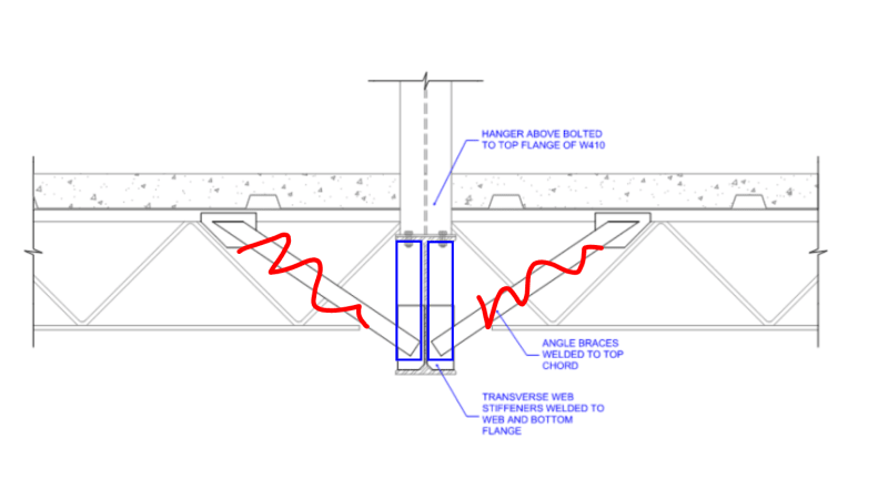

I'm confused by that. Your plan, ultimately, is to rotationally brace the beam at the hanger and at both adjacent inflection points, right?
To an extent, the hanger condition will be inherently stable. It's similar to bottom flange loading (below shear center) on a simple span beam and it will take some doing to get the beam to roll upwards at that intermediate support.
The hanger itself may be able to provide the rotational bracing at the intermediate support. It depends on what the hanger is and what it's connections to the beam are like. Can you elaborate on that, preferably with a sketch?
If both adjacent inflection points are rotationally braced, it is possible to make do without rotational bracing at the intermediate support. That's not my preference, however, so let's only go there if we have to.
Get yourself a copy of the AISC steel specification which is freely available online. Appendix 6 contains requirements for bracing which are, in my estimation, the best available in North America at this time.
Also, give some thought to the fire rating of that hanger. This is more of an issue for roof supported hangers but, perhaps, still something to take care with for your situation.

Sorry if I made that confusing but my question is, am I correct for considering the buckling in plan of the last 25% of the beam cross section due to the axial compressive force that develops because of the moment couple (See the second detail attached)? The bottom flange is only supported from buckling in plan from support to support regardless of the bracing at the inflection point, since the bracing at the inflection point only extends 75% down the beam depth and is rotationally restraining the beam up until that point.
The ex. hanger condition is also shown in bracing detail 1. The hanger is bolted to the top flange of the W410 (from what I saw on site).
Don't sweat the 75% thing. Like I mentioned previously, 60% for a roll beam bracing scheme, which is what you have here even though it's OWSJ, is commonly considered adequate to brace both flanges.

I've already got the go ahead for my intermediate support bracing detail so retracting it may be redundant.
I'd do it as I've shown it below. You want the stiffeners run up to the hanger as web depth (not full depth) so that you can mobilize the hanger in flexure as the roll bracing element for the beam. Think of the stiffeners as a downward, flexural extension of the hanger. The kickers will work however:
a) They mess with the natural deflected shape of the joists.
b) They cost money.
c) Stiffening the top flange removes flexibility from the connection in a way that stiffening the bottom flange does not.
How sure are you that this is a hanging condition rather than a transfer beam connection? A bolted base plate to an unstiffened flange is a pretty crappy hanger setup in many respects.
Some engineers will prefer the kicker braces owing to their greater bracing stiffness.

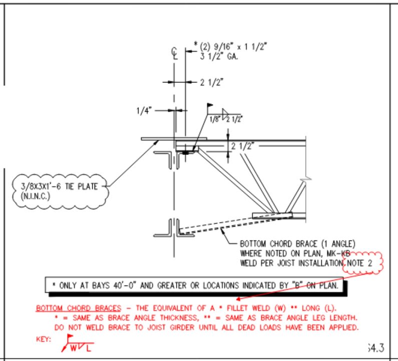

It's joist day I guess! OWSJ / OWSJ Girder designers use a really crummy similar detail to brace the bottom chord of joist girders - just an angle with realllllly janky welds to the girder and the joist bot chord. I've seen these welds fracture. No gusset/weld plates - just welded along the edge. They do note that these braces shouldn't be welded until all dead loads are applied though. Plus the tail of the joist seems pretty flex-y. Maybe flex-y enough to not affect the joist internal forces, but un-flex-y enough to brace the girder for uplift?
100%, the beam span is too long and tributary width too large for a W410x60.
That makes a lot of sense. I'll pitch this to my boss and see where I can take it.
The lateral stability of brace / joist chord combo is the part that bothers me most. Usually:
1) The first joist bridging line is a ways back and;
2) The installation is rough enough that you've got a fair bit of P-baby-delta baked in.
I wonder if anybody's tried to prosecute an appendix 6, bracing check on the setup.
