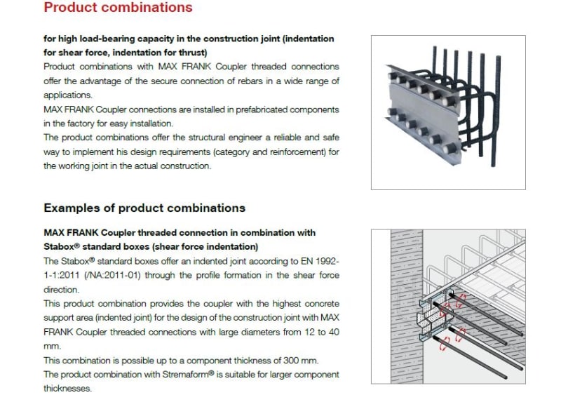

If your main question is the method of construction of the landing , i will suggest you the use of threaded couplers with shear key .
If i were , at least i would try the use of drop beam under the landing . Say My two cents only..
