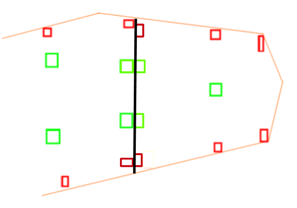

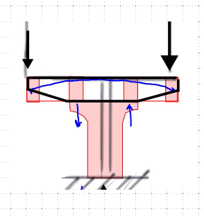

I have uploaded a sketch below showing the project I am designing, This transfer slab is going to support 5 stories above. Because there are bedroom above and I couldn't shift the columns above inwards so I have to put them on external and being supported by this transfer slab. The loads of each column above is roughly 200kN (Dead plus Live). Although I am not the one to design the PT transfer slab, I am not comfortable with this arrangement. But at the same time, I cannot shift the columns above 3.2 m inwards. (The columns below cannot move outwards they are on the external already, outside of them are roads)
What is your thoughts on this?

A low point below the centroid at the end of a cantilever does nothing for you. The moment at the column is still the same from the PT no matter what and the moment profile over the length of the cantilever from the PT actually hurts you as you are actually inducing more negative moment into the cantilever at any point where the tendon is below the centroid. You might think you are getting more uplift but you are inducing a moment in the reverse direction from the eccentricity that more than counters that.
It is actually better to have a tendon anchored above the centroid in a cantilever, for all of strength, crack control and deflections.
A Tendon pattern like KootK's will actually end up with at least 4 layers of tendons over the solitary right end support once secondary tendons are added. And curving tendons like that is not recommended especially with bonded PT.
My 2-way pattern gets around all of the problems and does everything required.

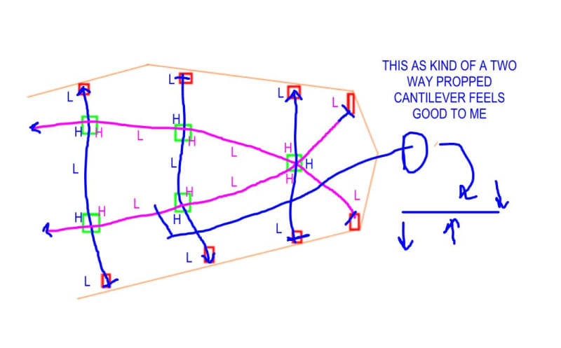

Whatever it is it is. Like I said, broad strokes. The main thing is the lows at transferred columns. And, in my parlance [low = lower than the highs] Not [Low = lower than centroid]

Nah, I can do it three. I'd only run secondary / uniform in the N-S direction. Regardless, whether it's three or four, you can get a lot done in what is sure to be an 18" - 24" thick slab once deflections are considered.

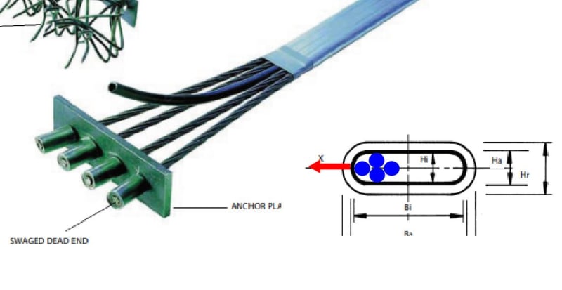

I and my market colleagues have been curving unbonded tendons more aggressively than this for decades, successfully. You just gotta:
1) Check the allowable radius on the cable
2) Check the inside bearing stresses on the concrete.
3) Check slab in-plane stresses in a 3D PT modelling software package and add PT/mild accordingly.
4) Toss in the usual hairpin / tendon spacing detail as such conditions.

2) Your load path is too indirect as shown below. It's basically an upside down simple span hung from a cantilever. My double, propped cantilever system is more direct and can, therefore, be expected to perform better;
3) At column D, your layout will have a confluence of tendons running EW which will mean that many of them will not pass over, or especially near, the column. As you know, that can be a problem. My layout, by crossing the banded groups, mitigates this problem and concentrates more of the tendons closer to the column.

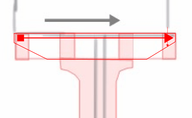

Piggyback on your idea but add meat to where it needs, and shed the excess to reduce the weight. Isn't that now looks like the bridge abutment with cantilever overhead beam!? It might be able to stop a truck now :)

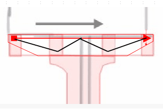

Alright, so the PT something like this then? right? Basically inducing end moments at the cantilever tips.
Yeah I see that now, for some reason I was imagining sloped anchorage giving you a vertical component but even then it would have a horizontal component and if below the centroid would give you moment additive to the transfer point load so counterproductive.
@retired13: the black is the soffit of the concrete beam?

Tendon, a lot of friction though.

I'd be curious to know, however, what is it about bonded tendons, but not unbonded ones, that creates the problem with curving them?
So I'm going to hazzard a guess and say that the problem with sweeping unbonded PT is that the strands gaggle up on the inside of the bend in a manner that is undesirable. As such, permanent separation between the cables cables is not possible in bonded PT as it is in unboded.

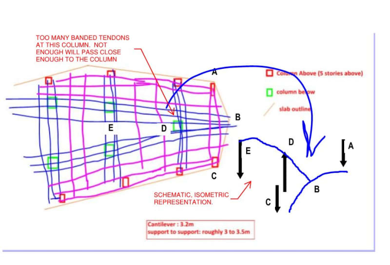

For the sake of the unbonded crowd now, I'd like to elaborate on what I was trying to do with the crossing PT bands setup. I've fictitiously represented the support bands of the system as beams in the sketch below to facilitate visualization. I feel that the double propped cantilever arrangement that I've been harping on sets up a condition in which the teeter totter business can be resisted by strong axis flexure acting over a lever arm rather than by slab torsion. I feel that's a worthwhile improvement in terms of efficiency, predictability, and robustness. In this way, I've attempted to tailor the framing to address the concerns specific to this building and this thread.

1 You have missed the second half of my load paths for the right corner columns. Horizontal bands back to the single column line supported by the vertical support strip.
2 If the column was made stiff enough and the foundation material was able to support a fixed ended column into the foundation to take the unbalanced gravity effects and any wind and earthquake effects, then you could make it work for strength. But not with the column as shown.
3 You cannot make it robust with modified load paths within the floor. If that single column below fails for some reason, the whole 6-7m of the slab to the right of the next row of columns back has to cantilever about 6-7m. If you try to use tension ties back up through the structure and frame action, it is not just the corner columns that have to transfer back, the next row of columns also has to transfer.
A normal corner column is not a worse case as you have suggested previously as the second row of columns is in trouble in this case and it is not a single corner which can act as a double cantilever in 2 directions, the whole end is stuffed!
