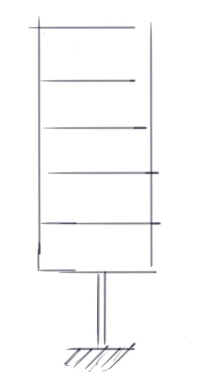

I have uploaded a sketch below showing the project I am designing, This transfer slab is going to support 5 stories above. Because there are bedroom above and I couldn't shift the columns above inwards so I have to put them on external and being supported by this transfer slab. The loads of each column above is roughly 200kN (Dead plus Live). Although I am not the one to design the PT transfer slab, I am not comfortable with this arrangement. But at the same time, I cannot shift the columns above 3.2 m inwards. (The columns below cannot move outwards they are on the external already, outside of them are roads)
What is your thoughts on this?

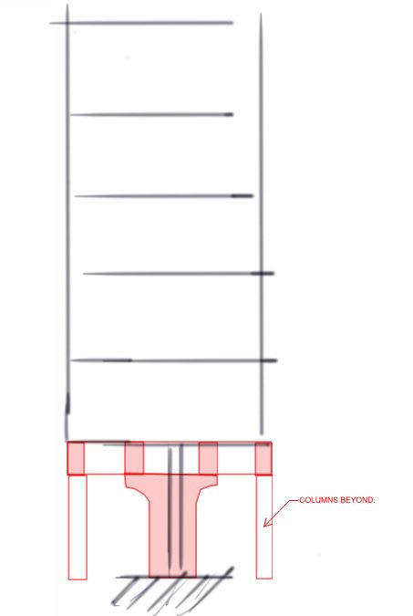

Or this version if one is considering the wallumn approach.
I think even the architect will shake his head on the first, the second looks very sturdy and traditional.

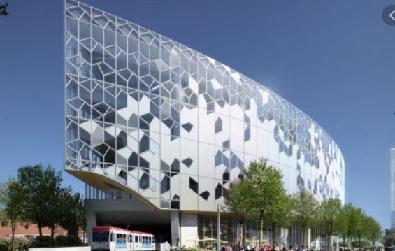

I doubt it. Calgary's new library is framed similarly (not me) and I can't recall a building receiving more architectural accolades. Granted, the perimeter setback is less.

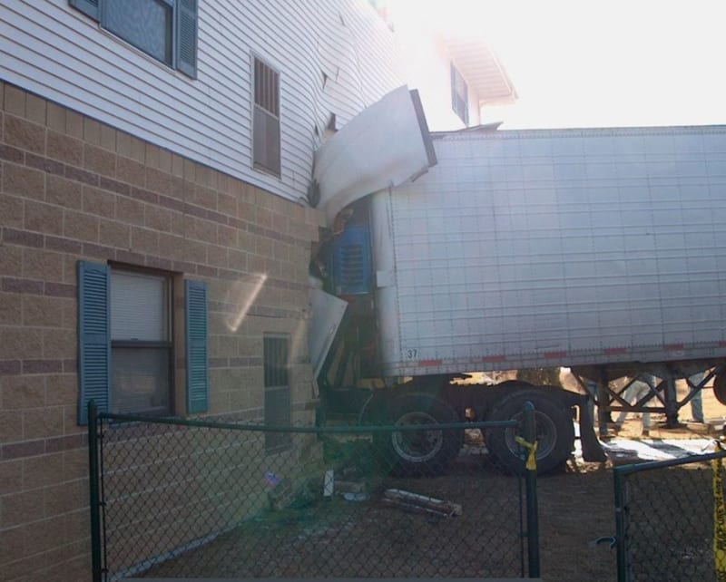

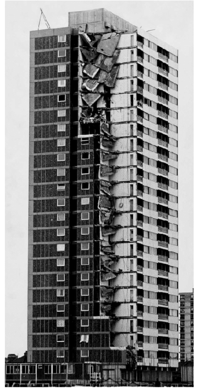

Not far from here in the 60s we had the Ronan Point collapse which kickstarted the discussion on robustness and disproportionate collapse in this part of the world.
A woman’s fridge blew (oddly enough!) and took out a load bearing wall, causing the entire corner of the building to catastrophically fail. We now have sufficient vertical and horizontal ties to give us a situation where the collapse will not be disproportionate to the cause.
In this case however, if your single column goes due to vehicle impact, poor construction or a fridge explosion... I don’t see how you stop the storeys above from spectacularly collapsing.
I also just read “outside of The lower columns are roads..”!!
So every day we have trucks passing the only column holding this thing up?!
If this was dragons den - sorry guys, I’m out!
That's the stock, fear inducement photo but, then, it's precast. I'd consider that to be a much more fragile situation.

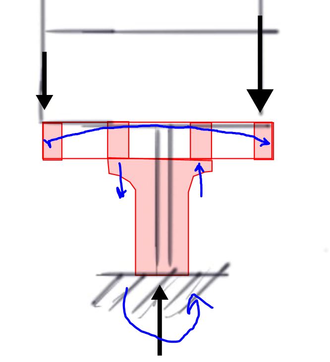

I’m also curious, and I’m certainly no PT guy, but in the out of balance load case below, is there a kind of stress reversal case where compression is lost in the slab?

I do however like the haunched wallumn and transfer beam. I could probably live with that.

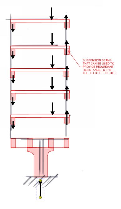

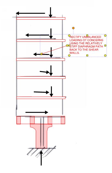

Or, what if one explored milking an upper level suspension system for a little OT resistance redundancy?
Something like this might be the more natural, and less invasive, way to get some OT redundancy.

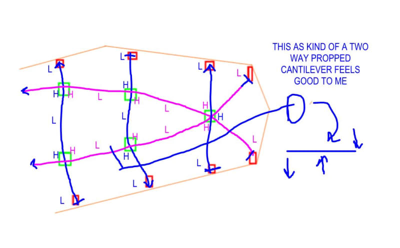

Sure, let's talk Turkey. Does what I've shown below, in very broad terms, speak to you at all? Banded - Banded with some infill distributed as needed. Obviously, you can only provide balancing for one load case so you'd have to pick what matters to you most and deal with the rest in mild reinforcing.

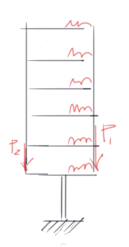

I'm having trouble seeing it. With an eye towards the sketch below, can you elaborate at all? Obviously, one would need to be a bit careful in detailing the column to slab connection to transfer the unbalanced moment successfully. But then that's just, you know, the usual, ridiculously complex STM & anchorage stuff that is our bread and butter.
Gut reaction, assuming the load on transfer slab other than the columns is typical residential loading, I would anticipate the whole slab to be in negative bending so the PT wouldn't have a traditional low point between columns. To really balance out the transfer reactions the PT is more or less going to want to be draped in a way to effectively add load to the central span. You'd also really want a low point out at the edge of the slab to help lift up the free end but not sure about the anchorage detailing most of my resources more or less dictate seating at the cross section centroid.
The reverse drape of tendons to a loading vs unloading shape in the span I think would make it hard to get service stresses to check out without staging the stressing to go along with the transfer level construction.
