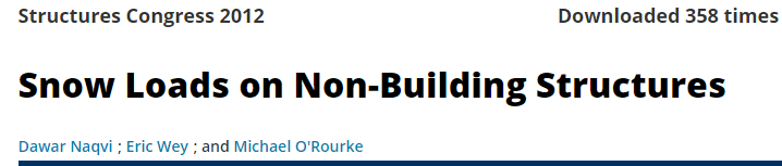

" ASCE 7 does not have specific provisions for snow and ice on non building structures and components. Process Industry Practices (PI) and American Petroleum Institute (API) recommendations do not give comprehensive design procedures or guidelines for calculating snow and ice loads on non-building structures and components. Engineering judgment is used for adapting the snow and ice provisions for buildings to non-building structures"
The above quote is from this paper published on ASCE. I dont think it has changed.

GC_Hopi, I actually think a bunch of the recommendations from that paper are in ASCE-7 now, if it's the one I'm thinking of that has things like maximum snow pile heights on thin items and snow bridging effects on cable trays.
I don't recall it having much in the way of icing, but I haven't looked at it in quite some time.
