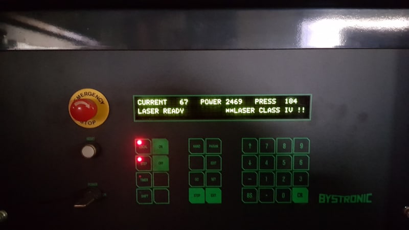

do you know how to do a power test? 2600 watts from a 3000 watt is not good. The current should be around 67 at full power.

I know how to to set power on resonator to 100% (Local & Step)

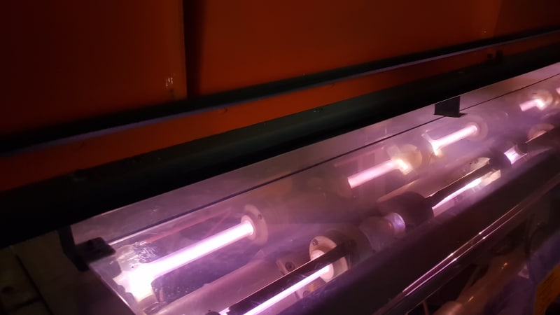

the resonator should be run for at leat 90 minutes after starting to insure it gets out of the fastmix stage. Then go to 100% power and watch the current and power reading. Also, open the top of the resonator and look at the discharge, if it is unstable you most likely have a gas problem. if the discharge is stable but the power is low, most likely an optics problem.

laser was running for 3 hours and I did power test. Current was: 67 and Power: 2469W.
There were no lighting inside glass tubes. And flow was normal.

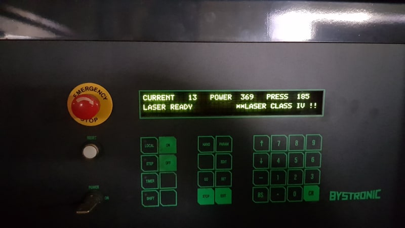

By the way I notice strange problem when we start resonator it always shows power around 550W on idle work, but after an hour of running this power decrease up to 350W
I would definitely try to find out why your power is low. check the optics first.
