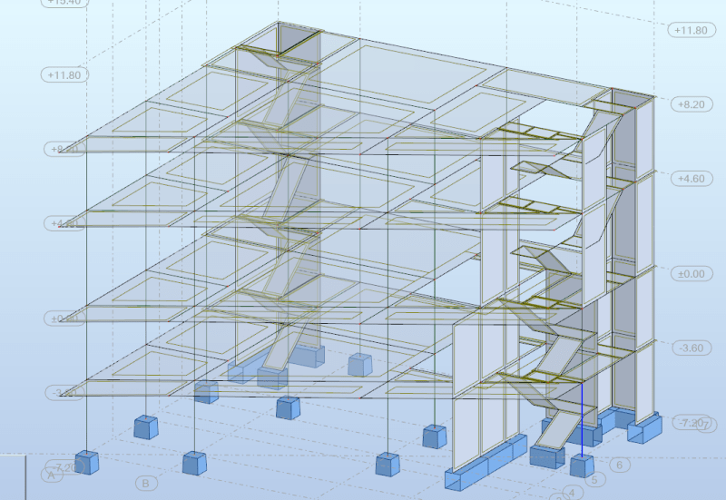

Hi all,
please find the attached thread:
javascript:openindex(450,450,'
BAretired said:
There are no beams on gridlines D and E other than walls, acting as deep beams and shear walls combined.
BAretired said:
The black object is hanging from the cantilevered wall above, which means that forms must be kept in place until the wall above cures.
So the black object is hanging from the cantilevered wall above, does this mean the cantilevered wall above (the dark green one) is acting as a hanger for the cantilever slab below (the cantilever slab at level +4.60) at the same time it acts as bearing wall supporting the cantilever slab resting on it (the cantilever slab at level +8.20)? If so, how it can be modeled in an FEA software?

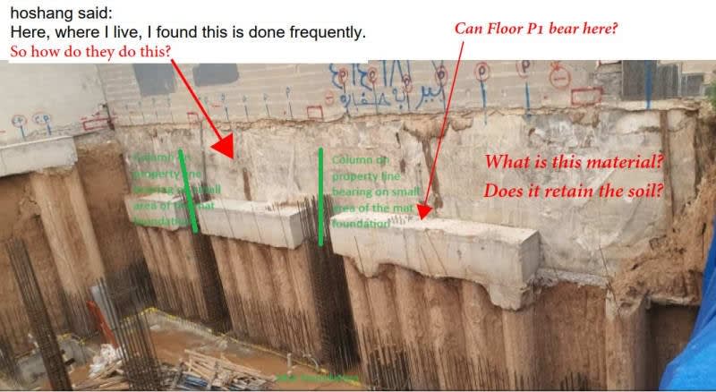

hoshang said:
I used a reduced axial stiffness at the bottom of the columns that are on the property line since these columns bear on small areas of the mat foundation.
Please find the attached image:
I meant using reduced axial stiffness for the green labeled columns since these columns are on the property line and they bear on small area of the mat foundation.
BAretired said:
The columns do not extend below Ground Floor and so far as I know, there will not be a mat foundation.
[li]We are definitely not on the same wavelength.[/li]
[li]The axial stiffness of the columns is not affected by what they bear on.[/li]
[li]Secant piles should form a continuous foundation wall on Gridline A.[/li]
[li]Columns on Gridline A start at Ground Floor and bear on a wall of secant piles.[/li]
[li]Leaving gaps for columns could allow soil to slough into the excavation.[/li]
[li]The type of soil is unknown, so we need a soil report.[/li]
[li]A mat foundation makes no sense at all. It cannot extend under the secant piles because they must be placed first in order to retain the soil.[/li]
The following was printed in light green text on the image:
hoshang said:
Column on property line bearing on small area of mat foundation.
[li]This is not the concept shown on the architectural drawings.[/li]
[li]Columns should bear on a wall, in this case a wall composed of secant piles continuous along Gridline A. [/li]
[li]The proposed concept puts a large stress on the soil and a large shear and bending moment on the small nib projecting out of the mat. It is simply the wrong concept; do not use a mat.[/li]

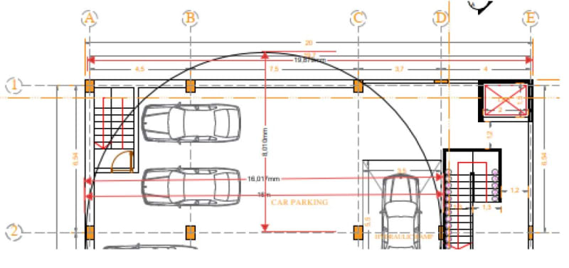

In addition to having insufficient parking stalls, the car in the Car-lift cannot make a 180o turn in the space available. The black semicircle shown below is the minimum space required to make the turn. Good luck with that!
The site is too small to accommodate the proposed building, even if it is downsized by one or two floors.
I know that The axial stiffness of the columns is not affected by what they bear on since k=AE/L.
My intention is when one needs to find the bearing area for a single column footing,
he uses this:
A=p/q
where p is axial load and
and q is the allowable bearing pressure
So I thought if I could reduce the axial stiffness of the columns, then it would attract smaller axial load and would need a smaller bearing area Since there would be a small area available for the columns on the property line.

Hi BAretired,
he uses this:
A=p/q
This is for single column footing. In my case I have a mat foundation. There would be a small area available for the columns on the property line. So I thought if I could reduce the axial stiffness of the columns, then it would attract smaller axial load and would need a smaller bearing area. The reduced axial load on the columns on the property line would be distributed to the interior columns. Am I right?
I don't think you are right. Axial stiffness of columns has little effect on load carried. Consider for example a continuous beam with two equal spans of length L, loaded with q kN/m and pin connected to three columns of similar area. Load on the exterior columns is 3qL/8. Load on the middle column is 2*5qL/8 or 10qL/8, more than 3 times the load on each exterior column.
While it is true that the central column strains a little more than the outer two, the difference is so small, it is ignored in design.
So you say, but why? A mat foundation makes sense when soil conditions warrant, but we don't know the soil conditions. Perhaps the foundation should be footings, piles or a combination of those.
in a statically determinate structure (a simply supported beam) the stiffness (and the relative stiffness) of the reactions points has no impact on the reaction forces.
in a statically indeterminate structure there are "too many" reaction points, so the relative stiffness of each (and the stiffness of the structure) play a part in distributing the reaction forces (that also complies with equations of equilibrium. That's why I think changing the stiffness (reducing some, increasing others) could be a possible solution. But there could be other concerns beyond simple loadpaths (local deflection limits ?) that also play a role.
Axial stiffness of columns has a negligible effect on load carried by each column, compared to soil settlement or deflection of the mat. Varying axial stiffness of columns is not a possible solution. It should not even be considered.

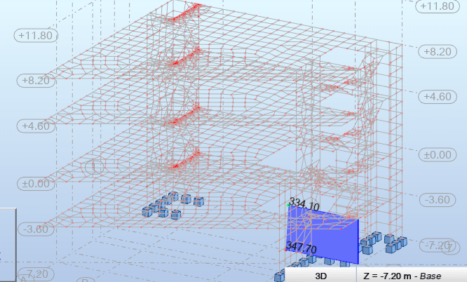

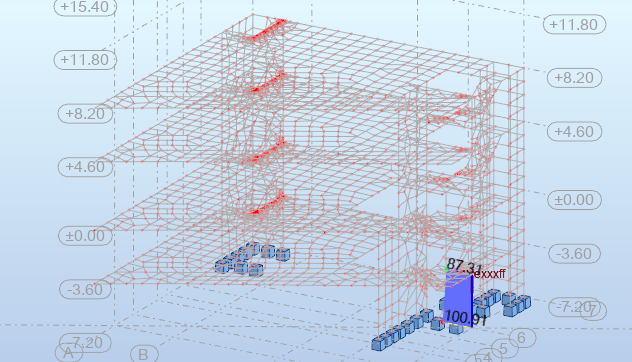

I worked around with my model with different axial stiffness of one column on the property line.
for self-weight case without release:347.70kN
Using elastic partial stiffness coefficient of 0.05 at the bottom of the column, the column axial load became 100.91kN
Impossible! You evidently don't understand what your software is doing. We're not even talking about the same part of the building. But I do not intend to argue about it. If you believe that result, carry on...without me.
