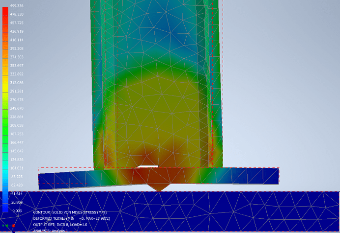

And here is a pretty FEA picture to keep everybody happy:

Could you please show the "rigid" boundary condition? A plot of the contact stress (plate-concrete), von Mises stresses and the rotation would be nice, since those could reveal the physical correctness of the model.

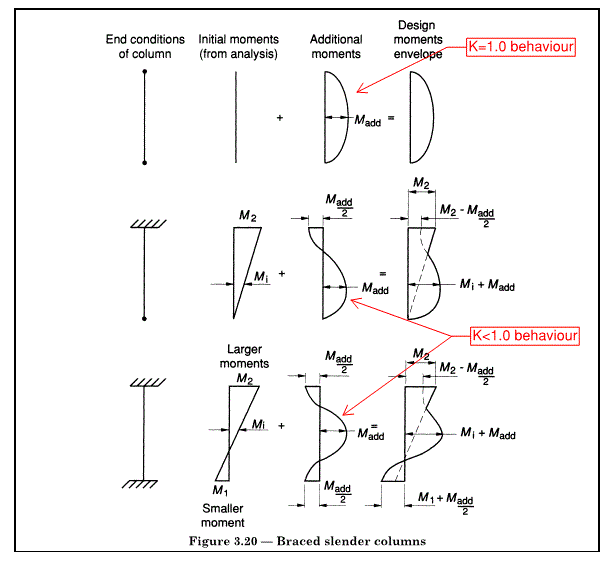

Clip below from BS 8110 to illustrate the non-linear moment in restrained-end 'buckling'. Note that 'M_add' isn't the same value in each case, and M_add/2 is an approximation.
Code compliance-wise, depends on the applicable code. Considering something fixed may trigger minimum robustness requirements which would need to be satisfied in the absence of the axial load. I believe these minimum robustness requirements typically apply on top of advanced analysis, ie you can't just say the analysis didn't require moment capacity from the bolts, because the robustness requirements are meant to cover the unknown/unquantifiable. Steel to concrete is a grey area though, in the gap between two codes.

I'm still not convinced by the physical arguments, but seeing those contact stress plots and rotation plots for the supposedly rigid connection without bolting would perhaps sway me.
