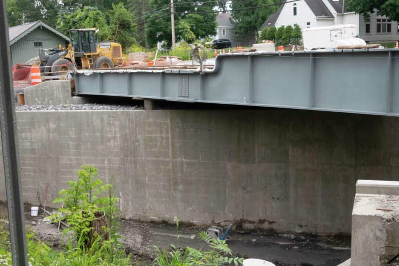

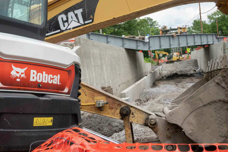

Such an odd bridge: continuous bottom flange, and varying top flange height with the middle section being taller. Moment demand wise, this makes sense, but that is a rather abrupt transition from the shallower section to the deeper section.
Oh my, what a horrible design detail.
My guess - some genius analyzed it with an FEM and only checked strength; never checked buckling. Have seen that too many times before.

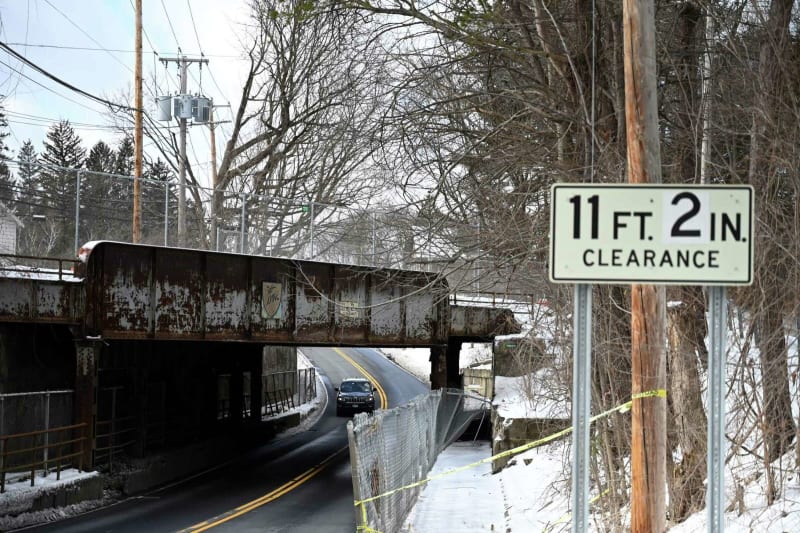

Wineland -- the story told elsewhere was that the newly fabricated single span bridge was meant to visually imitate the historic railroad bridge, which was three spans with a deeper and longer middle span.
Ah, that makes sense. Thanks Lo!
You might be right as this image is from that original link that bridgebuster posted:

Even the non-buckled side looks like it's partially buckled (unless my eyes are playing tricks).
They forgot to take the deep section to the support.

Looks to me like they just copied the old one. On the basis that it has survived 100 yrs maybe no one did any calculations??
Are the bridge beams asymmetrical due to the angled crossing? If so, it appears as if they put the bridge up 180° out. That explains why the support was so far from the taller beam section.
Look closer. They very roughly copied the aesthetic, but did not copy the engineering design of the old bridge. There's a big difference in design where the beam steps down.
There is also a big difference in design where the beam steps down between the two ends of the collapsed bridge
