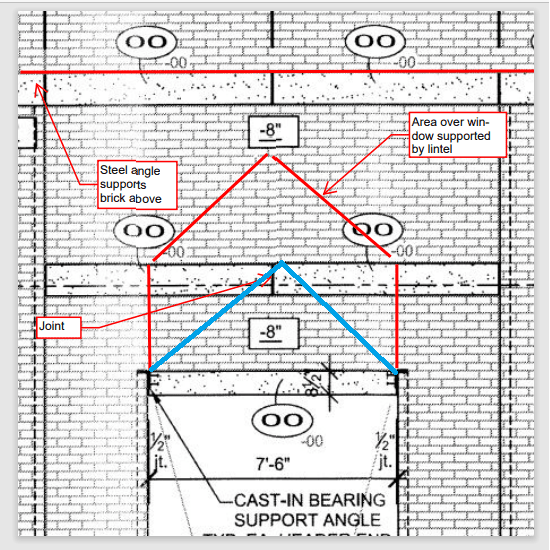

See attached. Have a precast lintel over a opening with brick above. Was trying to figure out the load to the lintel, as there are some other precast 'banding' thru the brick. Was trying to be conservative, but not too conservative. See attached for my thoughts on the load I should use.
