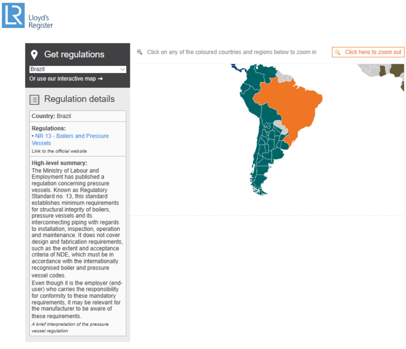

This tool by Lloyds Register may come in handy.
Brazil yields the following result;
Link to NR13.

In Brazil there are not any codes or standards that are mandatory for pressure vessels, they do have to comply with NR13 but it is mostly about documentation, and some inspection requirements.
Usually vessels are designed based on codes like ASME BPVC, EN 13445, PD 5500, AD Merkblatt, etc.
So to answer your question, you only need Stamps if specifically required by the customer. Legally speaking, the only documents you are gonna need are the ones which are mandatory per NR13 and the ART (Anotação de Responsabilidade Técnica) which is a legal document signed by the design engineer which is used to create a legal binding between the design engineer and the equipment. Another ART should also be created by the engineer who was responsible for the manufacture.
