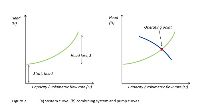

bmw,
I don't think you have as you still keep saying pd pump calling for "high fuel".
Unless your pd pump is a variable speed device (you haven't told us that), your pd pump can only do 200 lpm +/- about 10 l/min
Yu need to undestand also that you can't get sort of negative head / pressure. It physically doesn't exist.
PLease do some reading around pump curves and system curves.
YOu have a pump curve
You have a system curve ( head loss over a range of flow rates.
Draw them o the same graph
Where the system curve overlaps that is your MAX FLOW. as you will have zero m available for your pd pump.
Anything to the left of the intersection point will result in a positive head at the inlet to the PD pump.
Look at fig 2 of the attached
