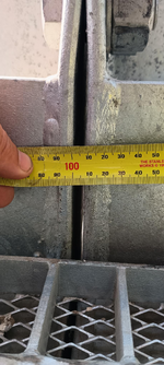

Exhibit A:
1738231879704-jpeg.4174
This is the bottom chord and walkway of a 20m truss gantry. This is a very ugly connection under tension as it is the bottom chord.
The bottom chord is HSS(125x125mm) and the verticals are 125x10Angle. 2xM24 bolts above and below the HSS chord. It is pretty clear that the 10mm plate section of the angle isn't stiff enough for the load here. (At a guess 25mm plate would be better)
This deflection is under dead weight only (which is about 80% of service load and 40% of ultimate load.) Bolts even with prying are more than satisfactory and the plate is unlikely to fail (I have yet to explicitly calc this out). How would you deal with this situation? Would you reject it? Perform significant rectification? Accept it if it calcs out?
Any thoughts appreciated.

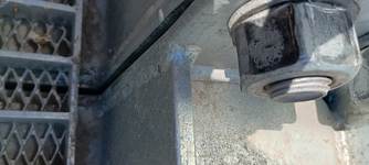

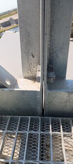

Oh and this isn't just one isolated join. There are several. Here is one with a larger gap. Including some minor weld cracking where the stress has been concentrated closest to the bolts.
Potential design issues aside, were the bolts properly pre-tensioned as they should be for this type of joint? It doesn't look like they were. I can see a gap between the plates at the bolt line. For that gap to develop at a pre-tensioned bolt there should have to be severe strain on the bolt. Maybe it is just the picture, but I would question the bolt installation. If this is recently erected, are there any visible marks that would indicate the bolts were pre-tensioned using a the turn-of-nut method?
If there is weld cracking (albeit minor) at 40% of ultimate loads, would this not be quite a severe cause for concern as fracture of the weld would be a brittle failure of the gantry?
Is it possible this is due to fabrication and fit up issues rather than flexural yielding of the plate? Only one side of the connection appears to have rotated.
Either way, if the numbers show that the first hinge at the HSS yield under dead load only I would certainly call for remediation. A 1/4" deflection is a common deformation limit for these connections, this Bo Dowswell paper is a good reference from AISC: https://ej.aisc.org/index.php/engj/article/view/1009/1008
How are the legs of the angles welded to the 'other" side of the HSS?

Another thing. There are a dozen joints similar to this. The one shown is one of the worse ones.
Good pickup and I picked up the same thing and observably worse in other joints. And the answer is a definitive no. There has definately been site assembly shortcomings as well as engineering shortcomings here.
For the joint that I supplied the photo for, I asked one of the workman to fully tension the bolt. When he started to do (I was not present), when he observed the local weld crack and stopped pending further advice.
In ANOTHER location, where the forces and prying was lower, the bolt was extremely under tightened and I could see plenty of daylight through at the bolt shank. I got the torque wrench onto this bolt before I tightened it and the bolt was approximately at 15% of required tension based of torque measurements which aren't an exact science in the field but give a approximate indication.
There is a HEAP of weld in there. So fracture at one location does not mean that there is a lack of capacity. The full amount of weld is ~3x what is required at ultimate capacity. So a tiny weld failure at one point does not necessarily mean it is understrength as a localised crack causes the load to be redistributed in a more favourable manner.
HOWEVER. I do think that the the most likely failure mode would be progressive weld cracking in a zippering type fashion. If the plate is bending to the degree it is, then the stresses get concentrated on the closest welds. If they crack the they get concentrated on the next welds in line and so on until failure. Additionally truss has equipment on it that will have regular (but not severe) vibration. So yes, this is a pertinent issue.
Both fabrication and fit up is far less than perfect. However there are several connection like this and the plates are definitely insufficient for the job. Thans for the link to the paper. I'll have a look.

Weld cracking

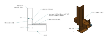

There is at least 750mm of weld in this joint due to the manner it has been detailed and constructed. The that crack there is a failure of 10mm so around 1%. But again the bigger question is more what is going to occur over time.
Here is a sketch.
As you can see due to the overlapping components (kick plate, verticals, channel underneath) there is not a even weld load path for the tension from the HSS chord to the bolts. An ugly configuration.
And the discussion so far has been mostly looking at the top as that is more accessible. The bottom is likely a greater concern due to the thin 6mm unstiffened web.
EDIT: I've done some extremely preliminary analysis of the channel. And I very much don't like it.**
** That is an understatement and I don't see how this design can be justified. Further discussions with the involved parties will be had.

Looks like some strap plates are needed, positioned like your tape measure.
