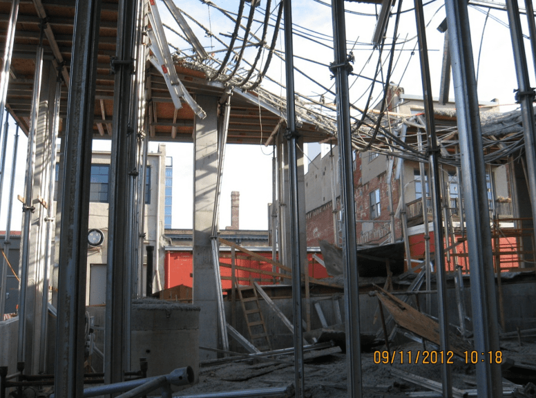

OSHA (in the US) has investigated several collapses due to such post-shore stacking - typically the result of contractors not following the manufacturer's written instructions based upon testing data.
Investigation of the September 6, 2012 Partial Collapse of a Slab during Construction at Hyatt Place, Omaha, NE ==> Link

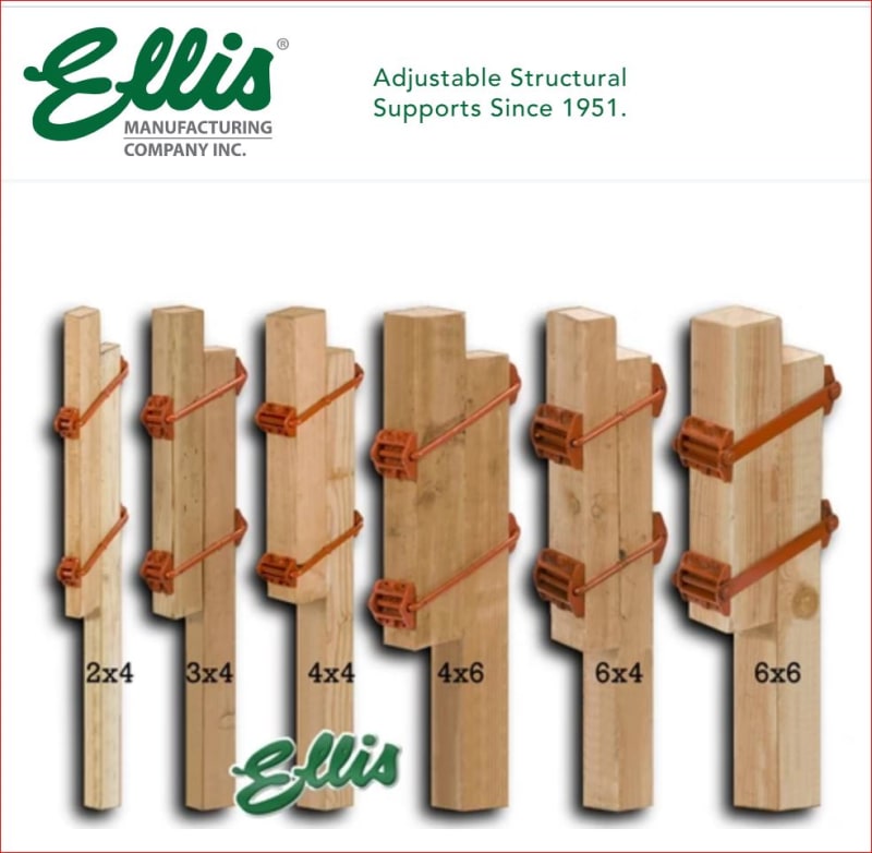

Could an Ellis shoring clamp work?
How about two medium props then bolt / screw bolt them into a large piece of timber then bolt the next one(s) on to of that piece of timber?
I think though until you actually draw this up and work out a way to avoid any moment forces on the prop, you're doomed to failure.
Those strong boy type supports impose a bending moment on the prop which is ok for a single one, but your joint is your weak point. Hence why welding them together might work, but small / uneven bolting won't.
