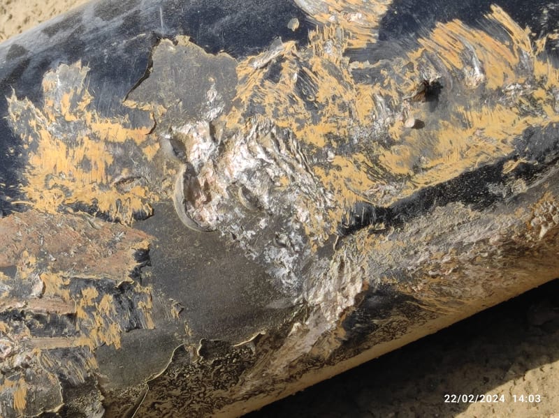

Feb 22, 2024 #2 TugboatEng Marine/Ocean Joined Nov 1, 2015 Messages 12,106 Location US It obviously hit something. Hydraulic cylinders are not meant to carry any side loading, only load from the ends. This is likely operator error. Upvote 0 Downvote

Feb 23, 2024 Thread starter #3 akv1234 Materials Joined Sep 29, 2021 Messages 6 Location IN Dear sir, The impact marks are in front side, which can happen when bucket is being raised , not on side . How do we explain it? Upvote 0 Downvote

Feb 23, 2024 #4 3DDave Aerospace Joined May 23, 2013 Messages 11,491 Location US Rocks dumping over the side of the bucket. Anyway, it's broken so replace it and then go to the job site and watch what they do to it. Upvote 0 Downvote
