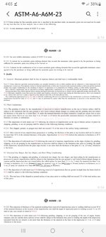

Here is an example of a typical ASTM spec
Recommended stock removal ro remove imperfections. Size needs to be adjusted
To allow for stock and to meet print thicknessScreenshot_20250410_040335_Samsung Notes.jpg
