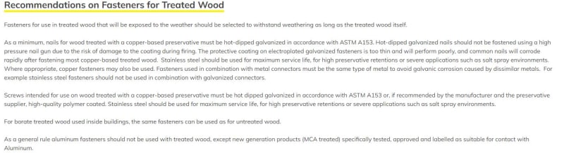

As far as I'm aware, standard nails/screws will degrade due to the chemicals used for the treatment. However my memory may be thinking of the old treatment chemicals, not the new. Last I saw in one of the canadian standards is either Hot-Dipped Galvanized or stainless steel are the only acceptable fasteners. But that was for preserved wood foundations, where the cost to remedy a failing fastener is substantial.
It depends on the type of treatment. Anything with copper is a no-go but I believe treatment with Borates or (the old style) CCA is compatible with regular steel nails (the Canadian Wood Council explicitly says as much, see second link below). Though your governing code may be based on all copper treatments and have a blanket statement to the effect of "only galv or stainless fasteners to be used with PT lumber"
Borates
CCA, MCA and Others by CWC
EDIT - If you're using the IRC I think you might be in luck (second attempt) if borate treated and the crawlspace is inside the building envelope.
Best bet is to have them provide the data on the preservative that was used. The manufacturer of the chemicals should tell you what fasteners are compatible.

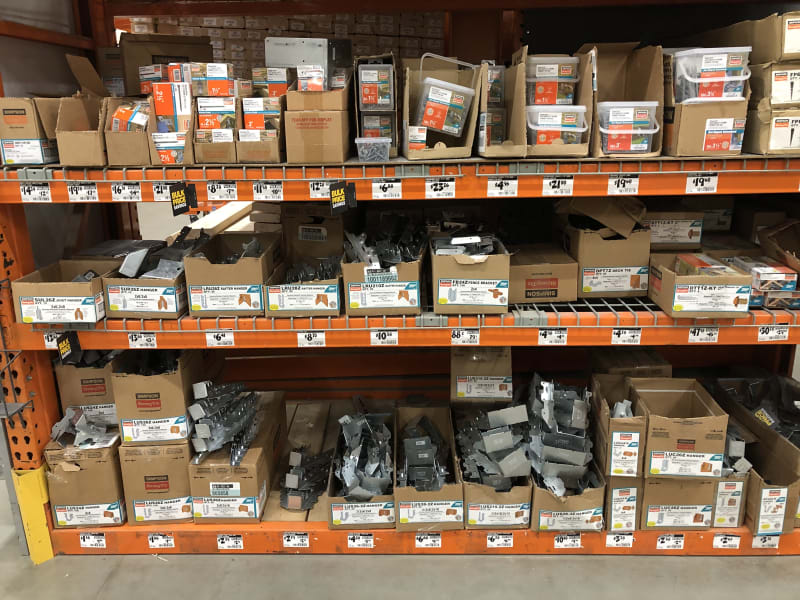

This is purely anecdotal based on building my own house and stopping at a multitude of Home Depot's, Lowes, & lumberyards, but it's almost impossible to find non-Zmax Simpson products these days. I think you'd have to go out of your way to order the plain galvanized ones.

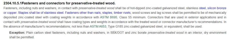

Pressure Preservative treatments vary, both in the amount of chemical used and the chemical itself. The general desire for heavier galvanizing is for the outdoor rated PPTs. Borate isn't outdoor rated. I wouldn't absolutely rule out Borate preservative treatment on a "normal" joist hanger. In construction defect, you need to prove there's a problem via (at least) documentation, research reports, in the product acceptance line, you're supposed to prove it will work, based on research reports, etc. (See IBC 104.11)
The contractor, ultimately, is the designer of record on a lot of decks, without being explicitly licensed to do design, but the product selection is on them when they function as the designer of record, as well as code compliance. Compliance with the specifications, when they exist, is on them as well.
Their ignorance, negligence, or skill, depending on the case, is their own. Starting work constitutes acceptance, etc. etc.
In all of the HD's/ Lowes' around here they only stock Zmax hangers, even tho the website is a little ambiguous as you found out. Seeing an LUS and not an LUSZ hanger in the wild is extremely rare from my experience, but like I said, that is purely anecdotal. I'm sure the next house I go to will have rusty LUS hangers all over.
jerseyshore, That has been my past experience as well, but I figured I'd check the website, and once I did, I wasn't sure if they perhaps changed what they offer in the store. In any case, it seems that it would at least not be impossible for somebody to get the non Zmax connectors.
Next time I'm in HD, I'll have to check.
To follow-up with my previous post, I was in Home Depot today and as far as I could tell, every Simpson connector in stock has the Z-Max coating. Good call on that jerseyshore.
