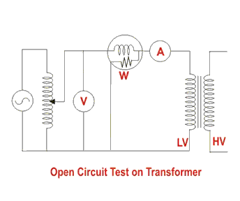

Hello,while I was checking another transformer through an autotransformer and some wires in the air I produced a dead short on the output of the autotransformer ... but the thermal switch upstream of the two transformers has not tripped. What tools could I use to check if the first Has the transformer been damaged? 🤔
Certainly help if you drew a napkin schematic for us and told us something about the transformers! Are they the size of your fist or the size of a pickup truck?
If the thermal didn't trip is the short still underway???! What interrupted the short?
Keith Cress
kcress -
Okay. The only damage I'd expect would be the wiper on the transformer coil. That's the foot that travels down the transformer coils.
I'd open it up and look at the path of bare wire that the wiper runs down. Look for a charred spot or soot. If you don't see anything setup a voltmeter to measure the output and then slew the autotransformer across it's full range very slowly while looking for any drop-outs or opens. If none are seen the transformer is fine.

okay, I'll check it visually ... thanks to both, in case I can use the connected oscilloscope instead of the voltmeter (hand voltmeter or numbers?)🙂
A meter would be better but a scope rated at that high a voltage with probes rated that high could be used. You want to sweep the knob looking for non-linearity or opens. With a scope you will see every tiny glitch including valid ones whereas a meter will average everything blotting out normal glitches. Be aware.

okay, i used the meter, and rotating slowly i did not notice anything abnormal except a couple of volts, less, however a voltage that was not stable on the DMM (+ - 0.5V AC) but i believe this is regular👍
The two worst cases:
An open; There will be no current and not output voltage.
Shorted turns; There will be higher than normal no-load current and the shorted turns will generate excessive heat.
This condition often escalates to destruction fairly quickly.
But, no smoke when you were testing voltages is a good sign.
