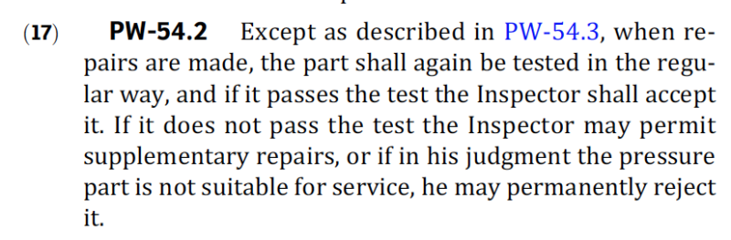

ASME Sect 1, PW-54.2
pmover
Sep 7, 2001
1,507
the above paragraph is new in 2017 code.
What is the "regular way"?

Regular way means code hydrostatic test. This wording has been in Section I for many years.

2004 Edition of Section I
PW-54.2 When repairs are made, the part shall again
be tested in the regular way, and if it passes the test the
Inspector shall accept it. If it does not pass the test the
Inspector may permit supplementary repairs, or if in his
judgment the pressure part is not suitable for service, he
may permanently reject it.
2001 Edition
the Inspector shall accept it. If it does not pass the
test the Inspector may permit supplementary repairs,
or if in his judgment the pressure part is not suitable
for service, he may permanently reject it.

This has been interpreted already by the ASME Committee. I-82-04.
Interpretation Number: I-82-04
Question(s) and Reply(ies):
Question (1): When performing a hydrostatic test on a vessel of welded
construction per PG-99.2, is any leakage through the weld(s) permitted?
Reply (1): No (see PW-40.1).
Question (2): What is the definition of the term "in the regular way," as
used in PW-54.2?
Reply (2): This means that the hydrostatic test required after repairs are
made shall be conducted in the same manner as the initial hydrostatic
test (see PG-99).
