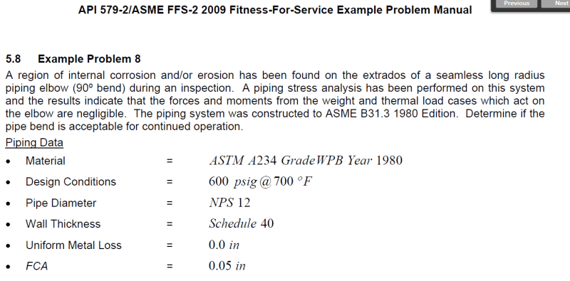

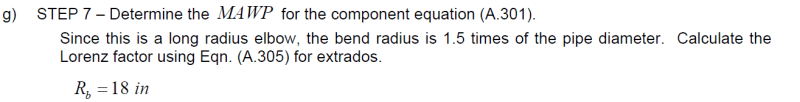

Ok In API 579 - the lorenz factor for pipe bends:
NPS 12 * 1.5 = 18

Based on OP:
R1 is the midline Radius...equal to Dimension A from B16.9....which is based on NPS not ID as all 2" LR elbows have the same A dimension, regardless of schedule.
D is OD of the pipe...d is ID of pipe.
