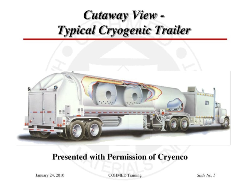

Liquid argon is cryogenic stuff though ; -186C so basically the same as LNG.
You'll need some pretty good levels of insulation and no idea how they transport it.
By Cryogenic Road Tankers of course. :-)
Uni job was doing QA/QC certification for NASA's liquefied gas loads.
They were using a whole lotta' LOX back then.
Basically a whole LNG ship shrunk down into a road package.
