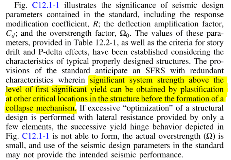

I disagree. See the second clip below which pertains to the overstrenght factor. That factor is there to allow the structure to reach the point of initial plasticity, push through strain hardening and all that jazz, and ultimately form a whole building VLFS mechanism.

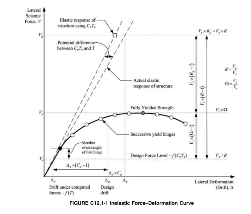

Here's a graphic from ASCE 7 which shows a point of "Fully Yielded Strength" beyond where it shows either the design drift, ΔD or the actual drift, ΔE. Assuming we are in agreement that the "Fully Yielded Strength" is the moment when the mechanism forms, then in this figure they are implying that no mechanism has formed for this design earthquake, but you are still able to use ELF with R and Ω.

I disagree. The load level reached at ΔD basically IS the mechanism load level for all intents and purposes. It's, what, 95% of the way there? If anything, I feel that supports my perspective.

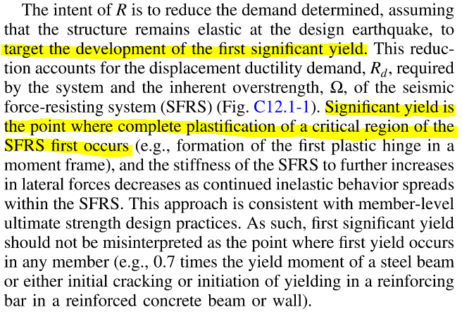

Here are a few more snips from the ASCE 7 commentary. First, from C12.1 (page 544):
And here's from the next page:
The first snip is saying that the concept of R and Ω is based on the structure reaching its "first significant yield." The second snip is saying that there is still strength gain after the first significant yield before you form a collapse mechanism.

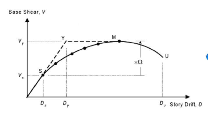

Let's get some terminology out of the way. The code snip above is mentioning a "collapse mechanism" which I would say is when the strength drops to zero, or to some prescribed lower-bound (often times 20% of initial yield strength). Based on what you have been saying, I think the mechanism that you are talking about is when no additional strength can be gained. On the figure above, the collapse mechanism may be the last dot, or the graph just stopped before it got there. And I think the mechanism you are talking about is the gray "fully yielded strength" dot. But based on my reading of these two code snips, R is only based on reaching the point of first significant yield - and it can't be the fully yielded point, since it says you still gain strength afterward.

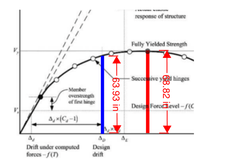

I also disagree with the claim that the graph is 95% of the way to the first significant yield. Looking at the deformation axis, because force is a function of deformation, it clearly isn't close to 95% of the way there. And even if it was, it's still to the left of it. If you need to go beyond that point for the methodology to be valid, then how sloppy would it be for that graph to show it to the left?
I believe that the whole building VLFRS collapse mechanism is represented by the grey dot because:
1) That is the point on the curve where the VLFRS capacity is at a maximum and;
2) That is the point on the curve where the VLFRS stiffness goes to zero and then becomes negative.
I disagree with your inference. I feel that you're putting the horse before the cart. It isn't the case that R is based on first yield but, rather, that first yield is based upon R. This is the "design" in our seismic design process. We give our members sufficient pre-yield strength such that the displacement ductility required of them is not exceeded.
R itself is defined as [ Omega x Ve / Vy ], with Vy being the load at which the whole building VLFRS mechanism forms. As such, R is predicated upon the existence of a whole building VLFRS mechanism forming.
I was speaking of the ratio of the length of the red line to the blue line as shown in the clip below. It measures about 93%.
It's not sloppy but, rather, imprecise. Everything in seismic design is imprecise. This particular imprecision is rooted the equal displacement principle that underpinned Paulay's original formulation of capacity seismic design way back in the 70's.
