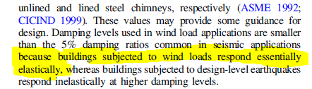

Per the commentary to chapter 26 of ASCE 7-16:
I read this as indicating that ASCE 7-16 assumes elastic structural performance for wind design.
