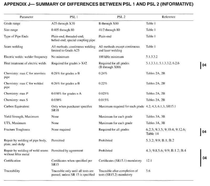

is there any difference in mechanical properties between API 5L X65 M&N&q or the are the same ?
also when i specify to the manufacturer M,Q or M
The required properties for each grade are the same, whatever be the delivery condition, since M is for thermomechanical rolled or formed, Q is for quenched and tempered and N is for normalized.
Amr Srag,
The delivery condition for PSL-1 pipe is at the option of the manufacturer, unless specified in the purchase order. For PSL-2 pipes, the delivery condition should be specified in the purchase order, as well as indicated in the grade name. See below for a difference of the two product specification levels.

Summary: You must order M, N or Q grades when the engineering design for the specific pipeline demands it.
A last thing: you need specify N, M, Q..... If you need PSL2 pipe, since PSL 1 no requires.
When PSL1, when PSL2???
R. again: engineering design and... Maybe a rule of thumb: liquids at room temperature or moderately different, could be PSL1. Others services, PSL2.
