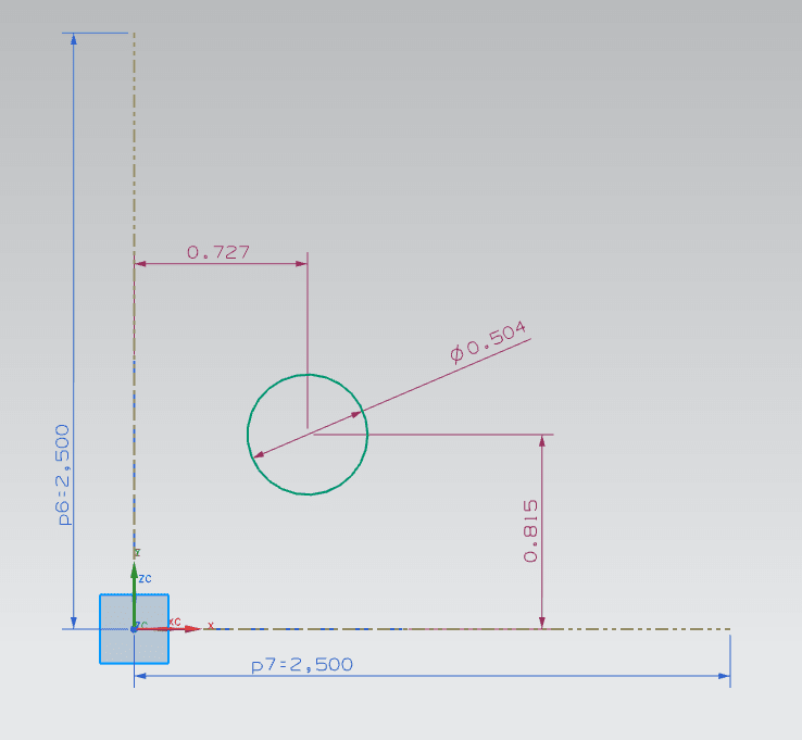

Hello,
I have a sketch of a circle that I would like to be at an angle off of a horizontal center line. I am unsure how to create this angular dimension. Could somebody please help me figure out how to do it? I am using NX 7.5.
Thank you

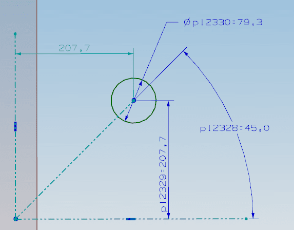

Would it work if you put a horizontal line in your sketch as only a reference line ?
I wish I could do better here, but it is hard without seeing your model.
Jerry J.
UGV5-NX11
The lines are reference lines, I am simply trying to get the circle at an angle to the horizontal reference line. The image above is what I have.
Create a reference line at an angle to the Horizontal one. Then place the circle centre at that reference line.
Ronald van den Broek
Senior Application Engineer
Winterthur Gas & Diesel Ltd
NX9 / TC10.1.2
Building new PLM environment from Scratch using NX12 / TC11
. . . Something like this sketch
