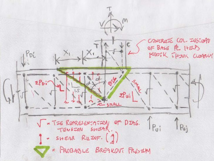

I've got 10 scratch scratch sheets on this just trying to get my head around it -
I think this arrangement makes more sense at the anchor head due to symmetry. I've also kept the theoretical ties orthogonal although I imagine the ties would be perpendicular to the splitting plane - a direction that makes the STM even more confusing. With this arrangement I can better visualize the moment compatibility through the depth of the footing (moment at the bottom of column = moment at the bottom of the anchorage.

@Teguci: I had to stare at your strut and tie model for a good twenty minutes before I fully grasped the subtlety of what you did there. It's brilliant. Creating a strut and tie model patterned after an Appendix D breakout failure really elucidates things. After mulling it over for a few days, I took the liberty of attempting to refine and improve your model. My thinking was as follows:
1) Your STM suggested a breakout frustum slightly different from the one that I proposed earlier. I adjusted the model to reflect my assumptions regarding the breakout frustum. I believe that it would be inherently asymmetrical about the tension anchor.
2) With #5 or smaller ties wrapped around longitudinal bars, I believe that it's fair to move your point "A" up to the top of the raft. This simplifies the model some.
3) I moved your point "C" up to the top of the raft and adjusted the last strut coming in from the right to hit that same point. This is consistent with my expectations regarding the compression stress trajectories in these areas.
4) I've got a compression field arching from the column/base plate compression zone all the way down to the bottom of the raft. Most of the compression would be absorbed into the tension anchor as the strut passes by.
Also, I finally figured out what you've been doing with that "v" shaped symbol that you draw over your ties that are represented by Vc. It represents SQRT(f'c), right? I'm adopting that from this point forward.

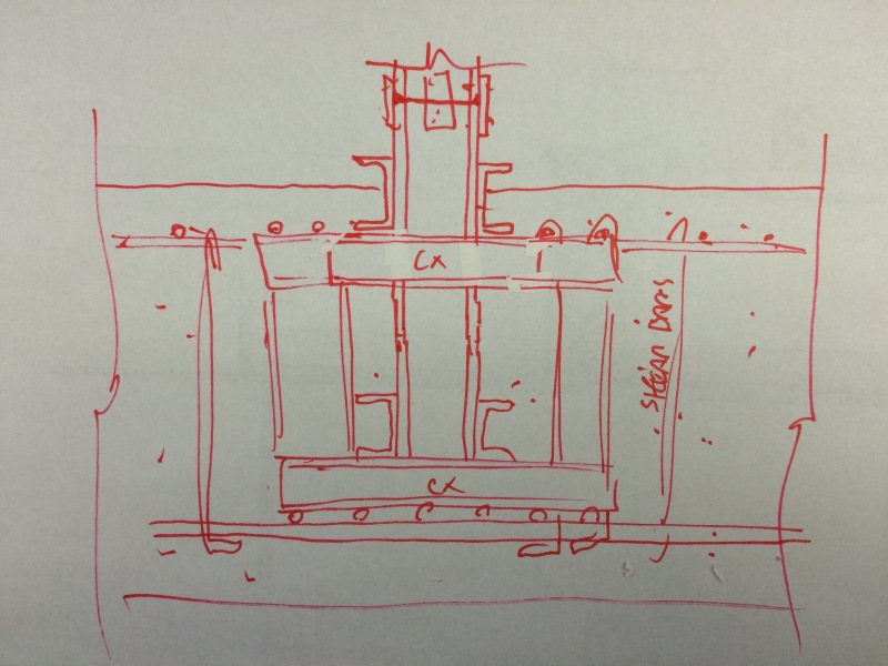

I have done it a couple ways: provided construction pad footings with base plates to set the columns on below the mat, designed grade beams above the mat foundation and have a base plate sit on the top of the mat foundation.
I have seen others weld on members (Cx) to the sides of the columns they then provide reinforcing to support the column.
Thanks for the clarification sandman. Could you elaborate a bit more on the last option? Two channels welded to the sides of the column and then...
To set the height of the Wx and check the column plumb they will weld a two or three foot piece of Cx to the flanges going in both directions near the bottom and top or as requried. They then set the Cx longitudinal bars while also tie to shear reinforcing, you can add as many Cx as need to keep the Wx secure. The provide I saw it on use the mat reinforcing and the contractor added some additional reinforcing to help. They only had the first splice at the first floor to limit the weight of the column.
Like this? I must have something wrong as I can't imagine one would leave any of the channels sticking up out of the footing.
That's the basic idea but without the Cx sticking out, they will add a layer of reinforcing, below the top mat reinforcing for the top Cx to sit on. I have seen this in deeper mat foundations, 8'+
Neat. I still find it surprising that one could install the embed that way, pour a bunch of concrete around it, and still be confident that the final position would be within tolerance. This shall be a new tool in my kit. Thanks for walking me through it sandman.
I make no warranties or guarantees as I have only seen the drawings for it. It makes sense to me and like I said it was on a large mat foundation with several layers of reinforcing for bending and shear, so it had three rows if I remember correctly.
Oh no, I'm doing this now and referencing sandman21 (interweb weirdo) in my specifications.

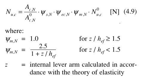

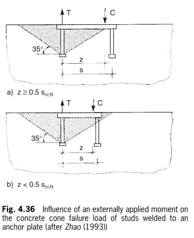

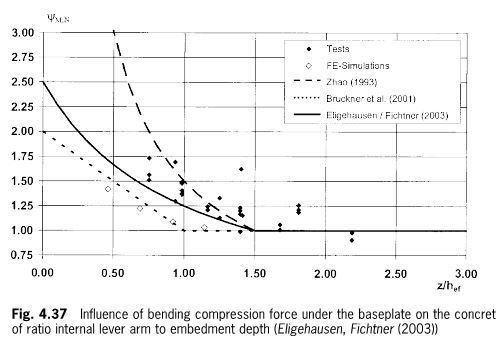

Did a little reading up on related issues last night: Link. The benefit of a moment induced compression force on the breakout frustum has been studied. I thought it prudent to share for the sake of others who might be interested.
In summary:
1) Work done by Zhao in 1993. I couldn't get my hands on the original stuff.
2) As expected, for the right combinations of lever arm versus embedment depth, there are marked improvements.
3) There's a proposed evaluation method but it requires determining a parameter (z) based on an elastic analysis. Not sure what to do with that in practice.
