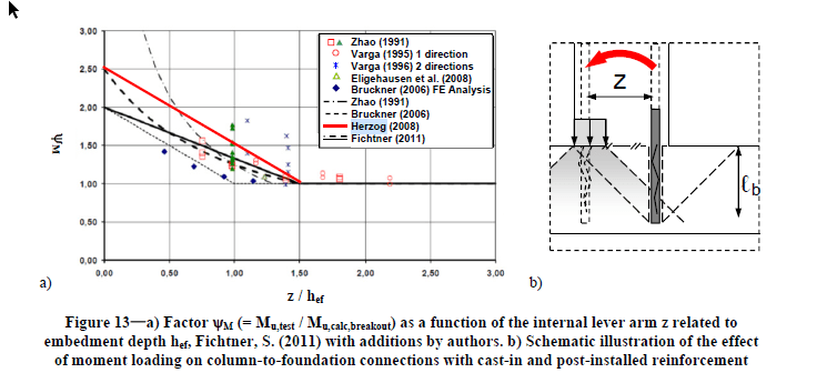

There are a bunch of different ways proposed to account for the effect KootK sketched. I have a handy graph showing the different methodologies and the resulting breakout strength modification. I'd suggest reading a couple of papers though if you plan to use it in a critical situation.
This is from "Bridging the gap between design provisions for connections using anchorage or strut- and tie models" by Eligehausen et al.

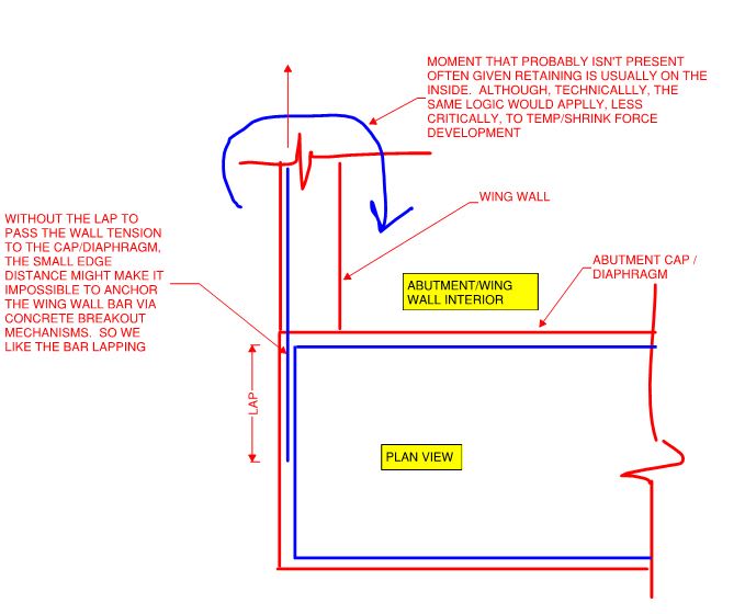

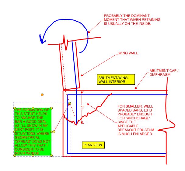

Well KootK, this may be a little off topic here, but I just have to say if I understand your contention that has been, in your words, the object of "ridicule and derision", I think what you're saying there makes sense. I'm sure it's much more complex than I can get my simplistic brain wrapped around, but what I hear you saying is that in order to be able to have the resistance of the full strength of the bar, it has to be able to transfer the force to the concrete (development) and the concrete has to be able absorb that force (anchorage) or transfer it to some other steel (lap). If we didn't have to worry about the second part, we wouldn't need to lap reinforcing - development of the bars would be sufficient. Did I hit anywhere on the wall where the target is?
That would also explain a conundrum I've had with the details of our typical bridge abutments, and the reinforcing from the wingwalls into the abutment cap and diaphragm. The bars on the rear face of the wingwall and abutment are supposed to be lapped, but those in the front face of the wingwall that extend into the middle of the much thicker cap and end diaphragm, are only developed, since there's no reinforcing in the middle of the cap and diaphragm to lap them to. It's ok for the front face bars to be only developed because the concrete 'cover' is sufficiently thick in all directions that the bar is anchored. However, the bars in the rear face don't have enough concrete on the one side to absorb the tension force in the bar without failing and the bar breaking out, so they need to be lapped so that they transfer the force to other bar. I know it's a rudimentary example, but is it related to what you were explaining?

HR10 said:
That would also explain a conundrum I've had with the details of our typical bridge abutments..
I'm afraid that I don't speak fluent Bridge. I'll give it my best shot though. And, if I've gotten it right, then I do believe that this is applicable to your conundrum.

In my previous post, I highlighted some text in green because I wanted to refer back to it in this post. My strongly held belief is that:
1) the anchorage/development issue is much better when the distance between the flexural tension and compression is small relative to Ld. This would be the case for many things proportioned similarly to walls etc. This allows the tension bars to be effectively anchored back to the compression zone.
2) the anchorage/development issue is much, much worse when the distance between the flexural tension and compression is large relative to Ld. This would be the case with elements such as shear walls, as shown below. Here, the flexural compression zone stands no chance of being able to anchor the tension bars.

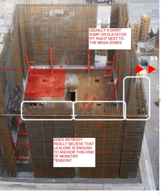

The shear wall example drives me nuts frankly. We expend gobs of computational energy sorting out performance based design, plastic hinges, etc for our sexy high-rises. All the while, my money says that half of these things aren't even stapled to their foundations properly. But Perfrom 3D says it passes so all must be right with the world.
And yeah, I get that the zone bars usually go to the bottom of the footings and that the footings are usually thicker than Ld. Still, though, given the consequences, I feel that the stakes are high enough for shear wall zone bars that their anchorage deserves some real attention. That, particularly given that it is rare for footings to be thick enough that the flexural compression zones can help anchor the flexural tension reinforcement.

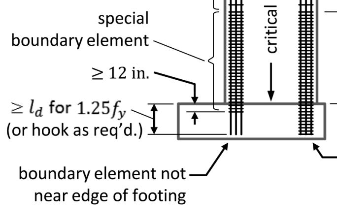

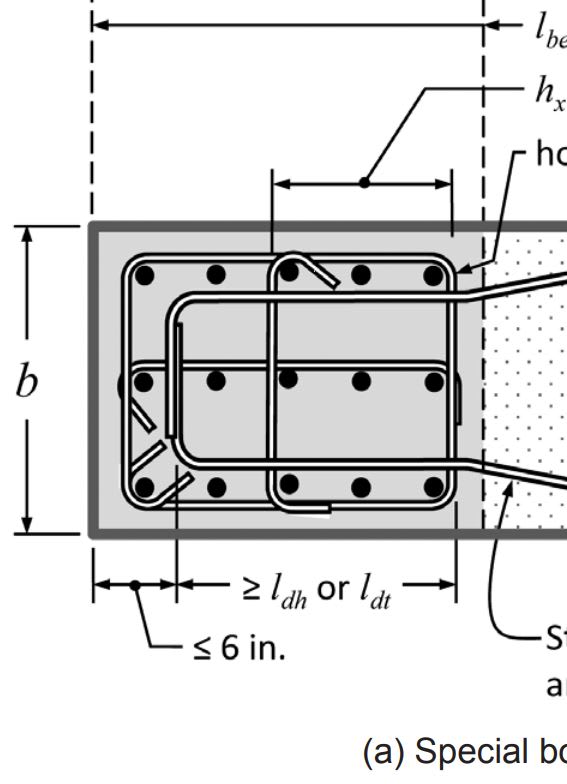

Check out the second sketch below from the NEHRP technical brief on concrete shear walls. Basically the best minds in the field telling designers to anchor their zones incorrectly. This is one of those areas where I feel that we need to acknowledge that the knowledge of practicing engineers is not just a subset of the knowledge of academics. Practitioner really do know some things that academics do not by virtue of our particular training and experience. And not just constructability / economic things.

With regard to the bridge abutment, I'm afraid I didn't explain the configuration very well. I was referring to what we call an 'elephant ear' wingwall, where the walls extend parallel to and in line with the rear face of the abutment (perpendicular to the roadway for a bridge with no skew). The wingwall is 12" thick with the reinforcing in the rear face of the wingwall aligned with and lapped with the reinforcing in the rear face of the abutment. The reinforcing in the front face of the wingwall extends into the end of the abutment between the mats of reinforcing in the faces of the abutment, which is typically 2.5' thick.

Got it.. elephant ears. It seems to me that my sketches above would still apply, however, just with the vertical wall element swung around to the sides of the cap/diaphragm. Agree?
HELP! I'd like your help with a thread that I was forced to move to the business issues section where it will surely be seen by next to nobody that matters to me:
The connection of the elephant ear wingwall is similar to the sketch, except there's no reinforcing in the end of the abutment, so no reinforcing crossing perpendicular to the developed bars through the concrete failure cone.
It probably would be a real problem, except that in-service there's generally very little soil in front of those wingwalls, so there's potential for only a small amount of tension in the front face bars.
