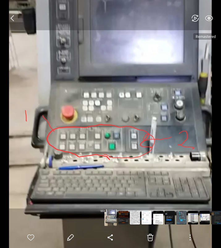

In addition to control on the shuttle table posts there is an accessory you can put on the main controller podium. Has the safety curtain controls as well as the lift table and workset options.The hardware for controlling the table is built into the main controller. The table side itself only has up down buttons for the lift table and an E stop with a few limit switches to tell controller table height.
 https://files.engineering.com/getfile.aspx?folder=04c51545-89dd-4452-bbfa-a270b8f33109&file=20190109_160736.jpg
#1 safety and shuttle controls #2 is lift table controls
