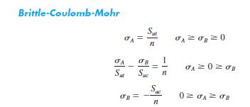

This time I would like to ask for help since I want to get a contour plot of a variable which is not default at FEMAP. I want to plot the stress field according to the Mohr-Modified Theory. I imagine I should use an API but I am not sure.

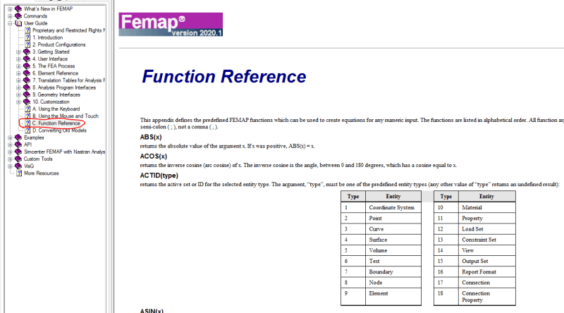

Run Model->Output_>Calculate to create new output vector based on existing stress tensor components. Read help to become familiar with Femap equation syntax.

Nonetheless, the equation that I want to write is a conditional one, as follows:
So I am wondering how can I write this equation in Model/Output/Calculate, or should I write an API? How can I do this?

Output->Calculate does not support IF/Else statements. Therefore, API is the only variant.
I don’t know Femap API at all. You may ask for help on this forum or at Siemens Community.
