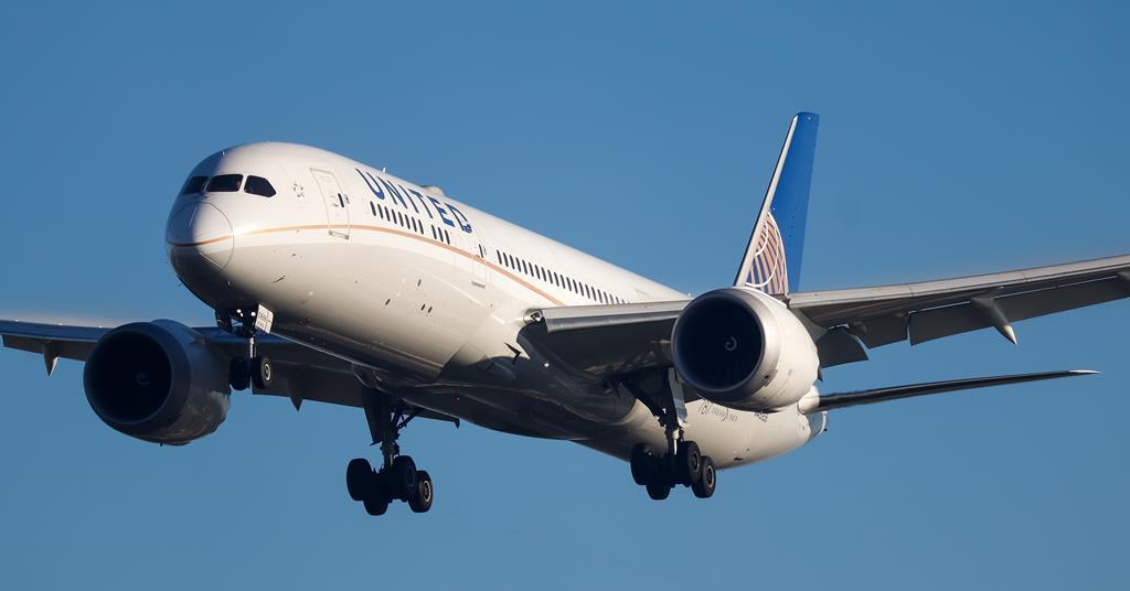

Landing gear retraction was initiated.
As explained by Greg's Airplanes and Automobiles, the retraction sequence tilts the main gear forward prior to lateral movement into the stowed position. Video footage clearly shows the main gear in the forward tilt orientation. The full retraction sequence for a 787 is seen in the Youtube short here.
It's almost as if the gear handle being used started a sequence.
