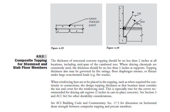

The following excerpt is from PCI Parking Structures: Recommended Practice for Design and Construction.
The double tee surface receiving composite topping should be roughened . The use of light mesh reinf. at topping should be considered.

Thanks for that reference HTURKAK. It seems like there's some merit to making the topping at least 2" thick to ensure any reinforcing that needs to be placed in it has proper clear cover.
