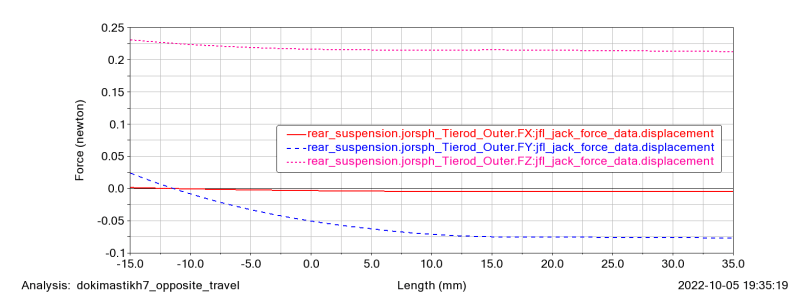

Hello, our rear suspension template has been running into some problems.
Specifically, while the opposite travel tests run normally, the outer tierod forces shown on the post-processing window are close to zero. This happens on every axis.
I have also saved the message logs from the same analysis:
Begin Static Solution
Time T=0.000000000E+00.
Degree-of-freedom analysis identified redundant constraints in the model:
- deactivating constraint equation Z Delta in model.rear_suspension.jorsph_Sph_Pushrodd
- deactivating constraint equation Y Delta in model.rear_suspension.jorsph_Sph_Pushrodd
- deactivating constraint equation X Delta in model.rear_suspension.jorsph_Sph_Pushrodd
- deactivating constraint equation Z Delta in model.rear_suspension.jolsph_Sph_Pushrodd
- deactivating constraint equation Y Delta in model.rear_suspension.jolsph_Sph_Pushrodd
- deactivating constraint equation X Delta in model.rear_suspension.jolsph_Sph_Pushrodd
- deactivating constraint equation X Delta in model.rear_suspension.jorsph_Sph_RLCA
- deactivating constraint equation X Delta in model.rear_suspension.jolsph_Sph_RLCA
- deactivating constraint equation X Delta in model.rear_suspension.jorsph_Sph_FUCA
- deactivating constraint equation X Delta in model.rear_suspension.jolsph_Sph_FUCA

STATICS: Original static solver will be used with the Sparse linear solver.
Static Solution converged in 4 iterations
Residual imbalance is less than 3.15365E-05
End Static Solution
Begin Simulation
Simulation(s) are complete!
Loading analysis results...
Loading results done.
Any help would be appreciated.
