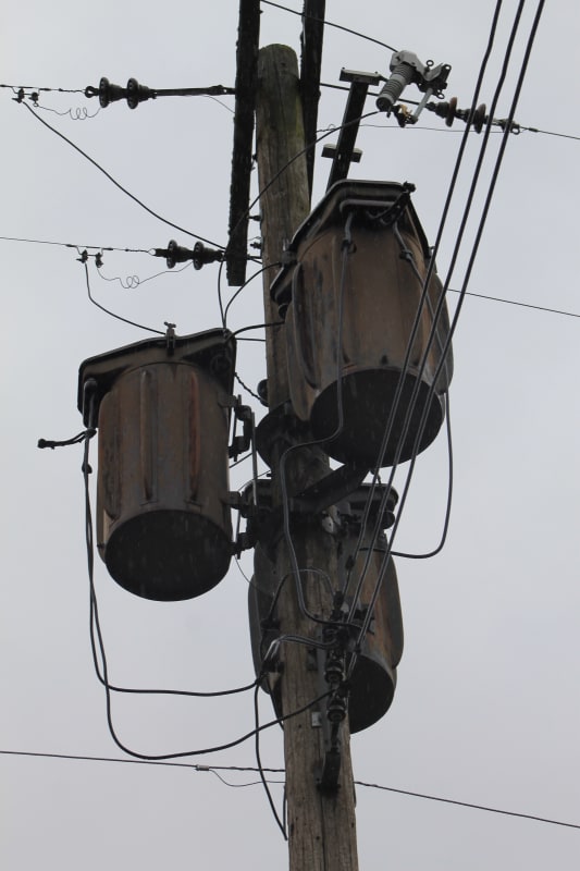

It's been in service for 80 years now and continues to carry load.
Is that an original delta:delta or was it upgraded to wye:delta 60 or so years ago?
Bill
"Why not the best?"
Jimmy Carter
I know the business owner. It is 12kV:440V delta-delta. He's got lights inside for ground fault monitoring and a 440:240/120 single phase transformer for lighting and outlets. This setup isn't long for the world. It is an island of 12kV delta surrounded by 20.8kV multi-grounded neutral service. They're stringing grounds in the area and starting to convert to one circuit at a time over.

Thank you for sharing that picture, Matthew.
I hope that you can give us an update after the conversion.
If they leave that bank in service, how will they handle the primary wye point?
Grounded with circulating currents?
Floating with higher voltage switching transients?
Fused? One partial solution was to install a fused cutout in the wye point connection. When local maintenance was done, the fuse would be installed in the wye point cutout to avoid switching transients. When all three phases were energized, the neutral fuse would be removed to avoid circulating currents and the wye point would be left floating.
I saw such a bank some years ago. I went back a few years later to take a picture but it was gone.
I suspect that they will retire the old transformers and go with 277 Volt pole pigs for a 480/277 Volt supply.
