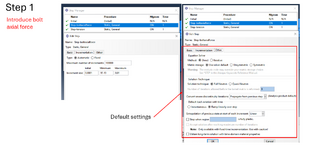

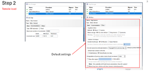

A extremely thin layer of adhesive between two steel plate with the pressure by Abaqus
Yao Lingbo
Jan 16, 2025
1
1737020172602.png1737020138247.png1737020112454.png1737020071510.png1737020034920.png1737020002477.png1737019964360.png(Here is picture, you can cleck to watch) I am trying to analyze a bolt-bonded hybrid joint, which has an extremely thin adhesive layer (around 20 μm) between two steel plates, with the steel plate thickness being around 20 mm. All materials are modeled as solid with an elastoplastic bilinear constitutive model.
For the analysis, I set two Static, General step with Nlgeom enabled.
However, due to the large difference in Young's modulus between the steel plates (206,000 MPa) and the adhesive (approximately 3,100 MPa), I suspect that the adhesive layer undergoes significant deformation when subjected to both the bolt axial force and the tensile load. As a result, the analysis is interrupted at the first step (introducing the bolt axial force) due to large deformations.
This issue has been troubling me for several months. Could you provide advice on how to solve this problem?
Thank you very much for your assistance
