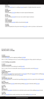

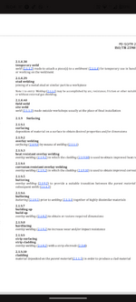

If we were informed of the articles that the OP has under consideration then we might have a more meaningful discussion.
Attached the definitions under ISO.

Ha! You have more experience than me but my experience is the opposite - in my corner of industry, cladding has always meant welding down sheets of thin high-alloy over plain steel. That cladding is only attached at the edges and any plug welds. Overlay is depositing continuous weld on top of the base layer.
I am aware of explosion cladding, which bonds the materials, but I've not worked with it.
It's safe to say there are many other processes that have 'clad' or 'overlay' in the name.
Murphy's law therefore means I've aligned the planets now so I'll shortly encounter a customer specification that declares 'overlay is strictly forbidden. cladding is acceptable' and the bid will be due the next day.
So I agree, if this isn't a (poorly framed) homework question, it can't be answered intelligently without specifics.
