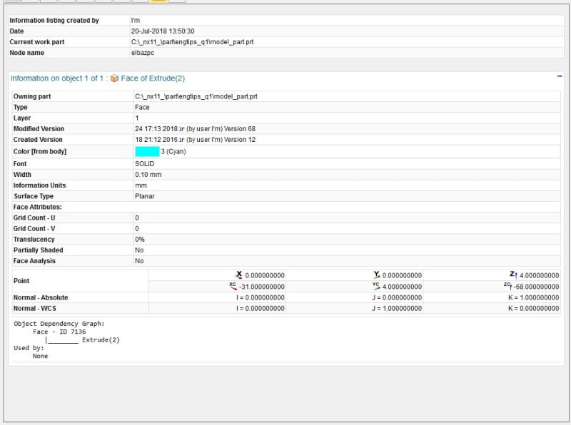

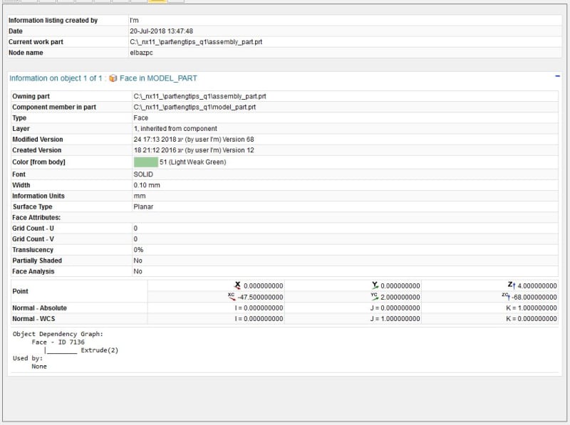

Hi
As shown in the pictures and on the atached zip
the colored two blocks don't apear no in assembly and in component model part.
Can some help explain to understand this assembly behavior
This is the assembly structure
This is the assembly part navigator
This is the model part
Thank you in advanced.
same face diverse colors
The 2 solid bodies have been assigned the color 51 at the assembly level. With the assembly open, go to part cleanup and for the "component display" option, use "remove all changes". The blocks will revert to the same color as seen in the model.

In an assembly, you can change your selection filter to solid body (or face) and change the color of individual objects in components. These color changes only show up in the assembly.
Ehaviv said:
Is it right that it works for a partial component.
To the best of my knowledge it has always worked this way, so I assume it is working as intended. If you can make a good case that it should work differently, please contact GTAC and open an incident report (IR).
