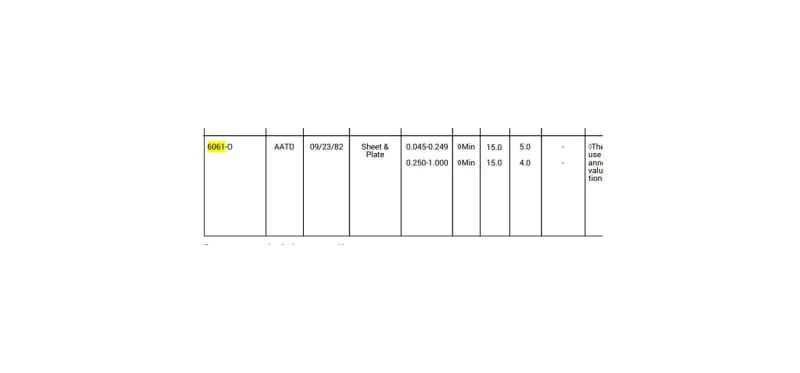

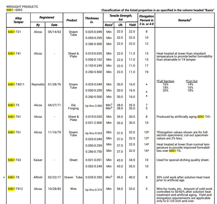

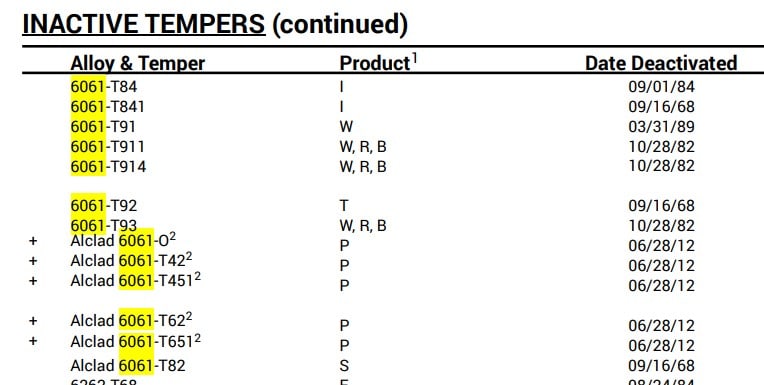

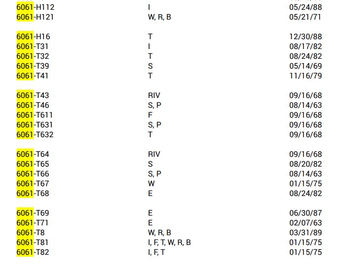

DANG I stand corrected... obscure tempers for 6061 do exist... see bottom of this chart extracted from Aluminum Association YL-1-2018...
CURRENT ACTIVE TEMPERS...
INACTIVE TEMPERS...
DuhOooo, Now I feel really dumb... my head hurtz.

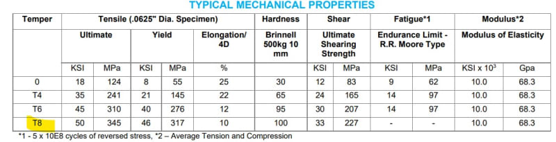

Hmm...Why is 6061-T8 listed under both active and inactive tempers? Was it deactivated in 1989 and then re-activated in 2017? I wonder if they make 1.9" thick wall tubing...
From Alfiniti's website:
