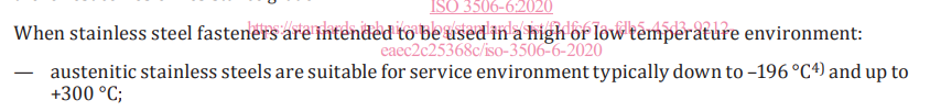

It doesn't seem to be an omission. It looks like the ISO committee has considered austenitic stainless and decided that the upper limit is 300C.
See ISO 3506-6:
On the spectrum of standard development, ISO tends to lean towards being supported by science and research; while ASME, ASTM etc. tend towards old farts codifying crap that they remember doing once.
It would be interesting to write to both committees with the same letter asking for their explanations of the difference.
What is the design temperature of these bolts you're looking to use? I'm not familiar with ISO standards, but it appears they are ahead of ASME in not allowing above 300 C / 572 F, as MintJulep mentioned. I've never installed austenitic SS bolting on any high temp application I've ever designed (up to over 1000 F bolting design temps). A193 B7 & B16 studs perform just fine up to these design temps, regardless of the flange metallurgy. And B7/B16 studs/bolts don't gall like austenitic SS bolting will inevitably do.
