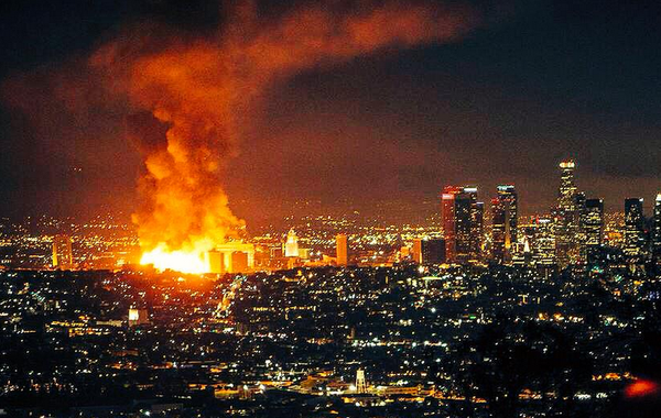

In December 2014, a large 7-story apartment building under construction with the top 5 floors made of wood, in downtown Los Angeles (at the intersection of the 101 and 110 freeways) went up in flames, wreaking damage well beyond its own property lines.
The LAFD spokesman said “There were no dividing firewalls between the different components of it. So we had five stories of a wood frame without any type of fire protection,”
There are many incredible pictures of the fire, easily found. Here's one:
