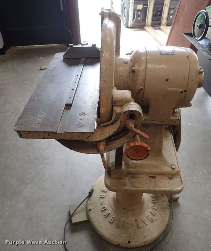

I have that exact sander!
Mine is pre-1936 as that is when Porter-Cable bought Syracuse Sander Co.
Mine is a 120 Vac, single phase.
I pulled it and a matching oscillating spindle sander out of a dumpster.
Odds are the motor was built with oversized bearings that a newer motor just won't have.
You will be much better off getting it re-would and new bearings installed.
The only thing that would keep it from being re-built is if the laminations are shorted.
You just can't beat that old iron these days without spending a lot of money.
If you go to what was "Old Woodworking Machines.com you may be able to down load the manual under Syracuse Sander if Porter-Cable doesn't have it.

DAVIDSTECKER - The motor did have different bearings - they were pressed on the shaft, sealed, and then the case side were pressed on - hence the messed up stator - me trying to get it apart. Does yours still work? I am just missing the brass gearset and two of the clamping handles. Part of me just wants to be done and then go and fabricate one from steel myself. Buy a cheap 5hp motor on Craigslist and build around it.
Yes, mine is still running.
All I've done to it is to replace the on switch and clean the ways.
I did tear down and replace the bearings in the spindle sander.

DavidStecker - Yep, they are great old pieces. Mine has anywhere from 1/4 to 3/8 of paint on it. Hard to even find any bolts or nuts. Going to take it all down and try to re-do it. Kind of hard in California - cant get a paint stripper that is worth anything and don't want to use a lot of power tools or even a sandblast cabinet as I am 100% sure the pain is lead.
