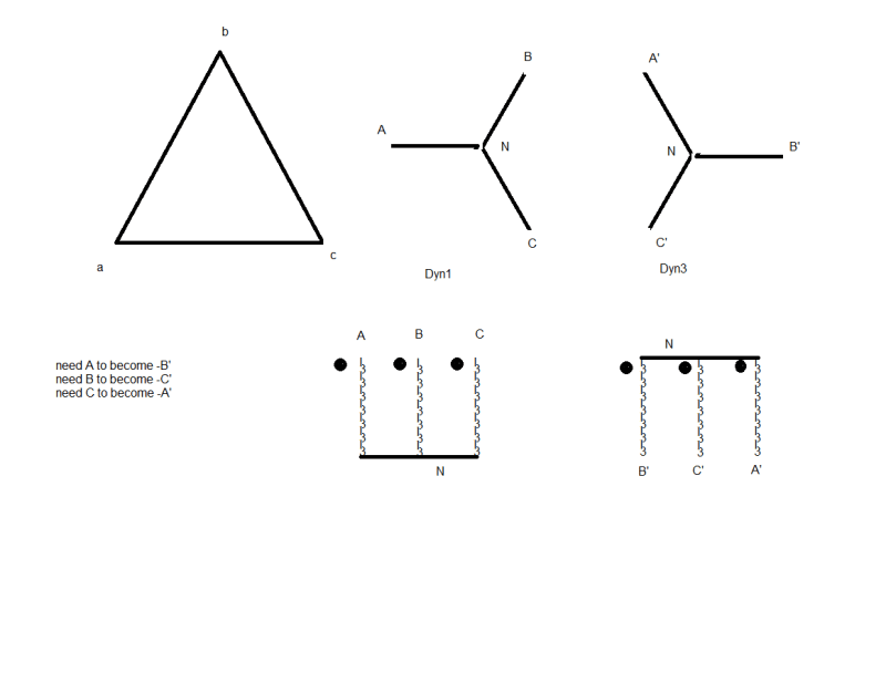

3 Phase Delta-Wye DYn1 transformer has primary terminal H1 connected to cable A, H2 to cable B, and H3 to cable C. The secondary terminal X1 is connected to cable a, X2 to b, X3 to c and X0 to cable n. The phase rotation is ABC on secondary.
What external connection changes, on either primary/secondary or both, will make this transformer DYn3, keeping the same phase rotation on secondary?
Thanks.
You'll have to swap two H connections and two X connections. There are at least 3 combinations that will get you what you need. I'll let you have a bit of transformer vector fun; then pick the one that causes the least trouble when reconnecting.

I measured voltages to check if the 2 sources in ATS are in sync. They are not. The voltage measured are A-A' = 120 volt, A-B' = 240 volt and A-C' = 120 volt. (Similarly for B and C phases.) So there is a phase difference of 60 degree between the two sources in the ATS. Both sources have correct phasor rotation. Obviously, We cannot do anything to the 120/208 volt coming from utility.
I wonder if our DYn1 transformer can be externally rewired as DYn3, (which gives additional 60 degree shift) and in that case, will it bring both sources in sync in the ATS ? Thanks.
Any delta-wye transformer can be connected to provide a phase shift equal to any odd multiple of 30 degrees.
The one time I had to put that into practice the actual set of swaps was determined by swap that worked at the vertical dead end a span away from the horizontal dead end over the transformer. Once that was determined there was one swap of low-side cables that completed the desired phase shift.
You would have to disconnect all 3 coils at neutral ends. At this power, these should be welded.
No. All done external to the transformer. Draw up a Dy transformer, the terminals are H1, H2, H3 and X0, X1, X2, X3. Assign A to H1 and a to X1, B to H2 and b to X2, and C to H3 and c to X3. Work out the vector relationship of ABC to abc. Now swap things around so that you have B-H1, A-H2, C-H3, b-X1, a-X2, and c-X3. Once again, work out the vector relationship of ABC to abc. It's different and it's some odd multiple of 60 degrees different.
As a hint, there's a FAQ for this forum that describes the "conversion" between Dy1 and Dy11, also a 60 degree shift. That doesn't require any changes inside the transformer either.

I was able to draw vectors and understand at least one cable reconnection configuration, which will give 60 degree shift. I did not attempt the other 2 combinations. But now I am convinced that it can be done and there are more than 1 ways to reconnect cables on primary and secondary to get the 60 degree shift.
Just a question of interest.......If the above 2 sources in ATS; one from utility 120/208V 3 phase 4 wire and second 120/208V 3 phase 4 wire from secondary of our Dyn1 transformer; were to be 30 degree apart, then reconnecting DYn1 would not be possible to give 30 degree shift such that both sources become in sync. Correct ?
