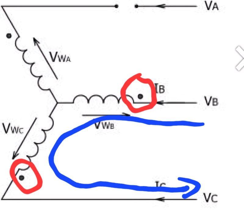

For a Y-y transformer ungrounded neutral, what will be the secondary and the primary voltages if phase A in primary is open?
With C phase missing;
Secondary A to B voltage. 87% of normal voltage.
Secondary A to C and B to C voltage, 43% of normal line to line voltage with the impedance of the dead C phase winding in series.
This assumes that a Y-y with ungrounded neutral* implies balanced loads.
With unbalanced loads, it depends.
*ungrounded neutral. This term is commonly used to describe a neutral that is not connected to the source neutral. I have used that common usage in this description.
However, if the term is used to describe a neutral that is connected to the source neutral, but there is no connection from either the source neutral to ground nor a local ground at the transformer, you will have normal voltages on two phases to neutral, normal voltage from A to B, and zero volts to neutral on the missing phase.

" ..For a Y-y transformer ungrounded neutral, what will be the secondary and the primary voltages if phase A in primary is open? "
I have the following results for your kind scrutiny. I stand to be corrected.
1. Assumption: the traffo is YNyn 0, with turn ratio 1:1. Therefore, Pri: VAB = VBC = VCA, = Sec: Vab = Vbc = Vca; taken as 1 pu. Where VAN =VBN = VCN = Van = Vbn = Vcn = 0.577 pu.
2. That is, vector VAB = VNA-VNB , vector VBC = VNB-VNC.... Where vector VAB and vector VBC... are 120 electrical degree apart.
3. Now consider that pri phase A is open, i.e. = VNA = 0 pu.
3.1 Pri: VAB = VNB = 0.577 pu.; VBC = 1 pu ; VCA = VCN = 0.577 pu.
3.2 Sec: Vab = Vnb = 0.577 pu.; Vbc = 1 pu ; Vca = Vcn = 0.577 pu.

I have made a circuit diagram with phase loss on A which provides the following conditions for Y-side;
UA-n = 0 V
UB-n = 0.5*UBC
UC-n = -0.5*UBC
Shouldn't the voltages on the y-side be the same i.e.;
Ua-n = 0 V
Ub-n = 0.5*Ubc
Uc-n = -0.5*Ubc
Yes.
But remember that those voltages are based on the assumption of balanced loads on the secondary.
In the event of unbalanced loads;
Ub-n and Uc-n will sum to Ub-c.
The division will be in the inverse ratio of the load impedances.
With badly unbalanced loads, simple arithmetic predicts that the voltage on the lightly loaded phase will approach Ub-c.
But the second thing to remember is that transformer saturation may limit the voltage rise on the lighter loaded phase.

Hi
As Waross pointed out, it is due to polarity. See image below.

Hi
The angles will not be like a balanced three phase system, they will we 180 degrees phase shifted.
If you look at the circuit provided the voltages across winding B (ZB) and winding C (ZC) will be as stated earlier. Consider that the winding impedances are equal (1 pu), then you get by voltage division; UB-n = UBC*(ZB/(ZB+ZC)) = 0.5*UBC. UC-n = -0.5*UBC = 0.5*UBC<180 deg due to opposite polarity.
