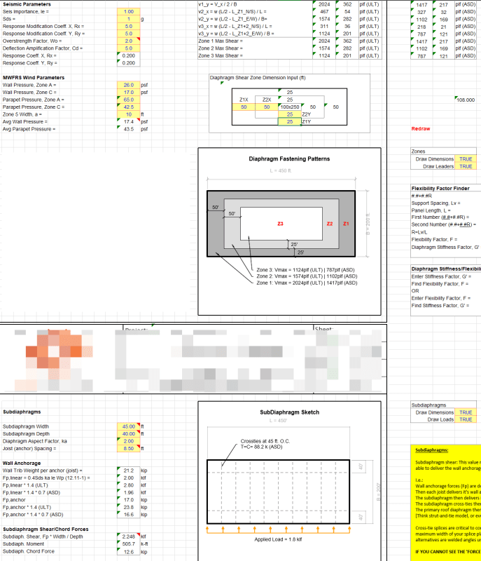

I have worked out a method to determine different zones for diaphragm strength independently in two directions.
Now I want to attempt to combine the results from each direction to develop a complete diaphragm zone plan.
1) I am pretty confident this can be done. I've seem some of the stuff @Agent666 does with python and I'm certain there is a way.
2) I am decent at python and pandas already.
I'd like to see if there is a good geometry library where I could first generate the regions from the data I have already calculated, then merge them together to make the graph.
Anyone know of a library that might simplify this task???
I have data sufficient to define the domain (in black) and I have coordinates of the transition regions between each color for each direction (A & B) from the image below. Just need an efficient way to merge the geometries that are similar to get figure C. I don't just want the graphical, I'd like to maintain the data of the solution as well.
Thinking over some coffee this morning your two data set boundaries are horizontal and vertical lines so by inspection you know all of the intersection points, corner coords of C, it will just be the combinations of (x,y) pairs of each line value. Take all of the those (x,y) intersection points and process into regions. A simple approach would be sweeping along the y axis and building the boxes of each segment in a bottom up order.
I'm making a thing: (It's no Kootware and it will probably break but it's alive!)
Thanks for the reply Celt I'm gonna poke around with this and where it takes me. I think a tool that integrates diaphragm analysis and design could be a big time saver. So far the user I puts the ordinates of the diaphragm shear diagram and they input what they want as a diaphragm (nailing) schedule then solvea the locations indicates on A & B above. It's already saved me wuote a bit of time :)
Use shapely, if each one of the colour bands is a polygon with the exterior edge (or you can make it a polygon), then look a the union command in shapely, it will return the combined commom area, then just take off the prior smaller area defined as a hole (if you work centre outwards)?
I guess ultimately it depends on what you want to do with the data next but that will get you the coordinates of the donut shape (shapely describes it as a list of coordinates for the exterior and interior hole(s). But I'm guessing it won't always be that type of shape.
Thanks both for the input. I am going to keep pushing to develop these zones, I think my end goal is going to be to export a .dwg or something similar. This could either be used directly on the drawings, or used in combination with CAD to make the process of drawing this diagram on the sheet much faster.
I will post back here any progress. Cheers!
