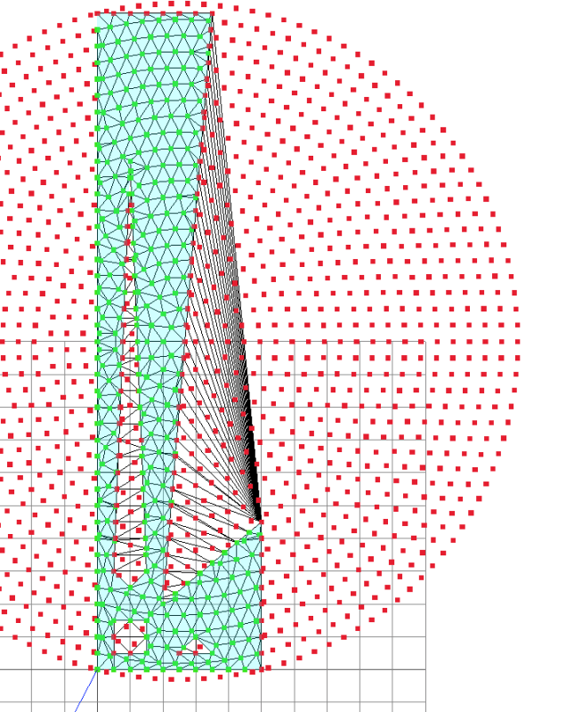

I am looking for a good text book/resource on finite element meshing algorithms. If you have any experience in this realm, I would appreciate some guidance on potential pitfalls/things to look out for regarding these algorithms.
Ideally the algorithm would be able to accommodate 2-d polygons with the potential for polygon holes.
Routes I am investigating
Route 1 - Create internal points within the polygon and use Delaunay triangulation to make the finite elements
Route 2 - Advanced front method

If you are looking for a robust and fast implementation for python, this library is a python implementation of the popular and free meshing library triangle. There are lots of options for constraining mesh size and quality.

I made good progress over the weekend using the ray caster algorithm, brute force point generation and delaunay triangulation.

I like the science behind computation geometry, but from a structural engineers perspective nothing compares to square/rectangular quads with internal angles close to 90 degrees. Very hard to do. I haven't really followed any science behind the meshing in my programs for mesh generation, but in doing so it really loses much of the general purpose functionality.
