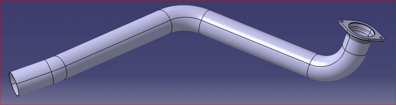

I placed the 3D picture of the model, just for evidence:
What do you think about this?

Thanks for revising the original post to include the entire drawing, as well as the image of the model.
I think the drawing makes sense, with the primary views and auxiliary views. So I don't see any problems there.
I think we both agree that it is much easier in CATIA to just create the Front view and then project views from there. But apparently the drafter of this drawing either didn't know or felt that Isometric views were the way to go.
Going forward, I guess you have 3 options if you are taking ownership of this drawing:
1. leave it like it is (and put the other guys name in the titleblock)
2. rename the isometric views so you (and everyone else who has to work with this drawing) know which view is which in the list
3. delete the isometric views and make all new views and new dimensions
Personally, I would go with option #2
I would also label that view to the left of the notes. Is that the Bottom View?
And I think Section View A-A in the tree is actually section C-C on the drawing, so that should be renamed.

It is preferred to have the views align with each other, the 3 main views do not.
The 2 "view in direction" views look like they are not in the correct orientation either (about 90° off).
Due to the low number of dimensions, I would recreate all the views.
Hard to see all the detail on a screen shot, but these views do not follow basic 1st or 3rd angle projection.
