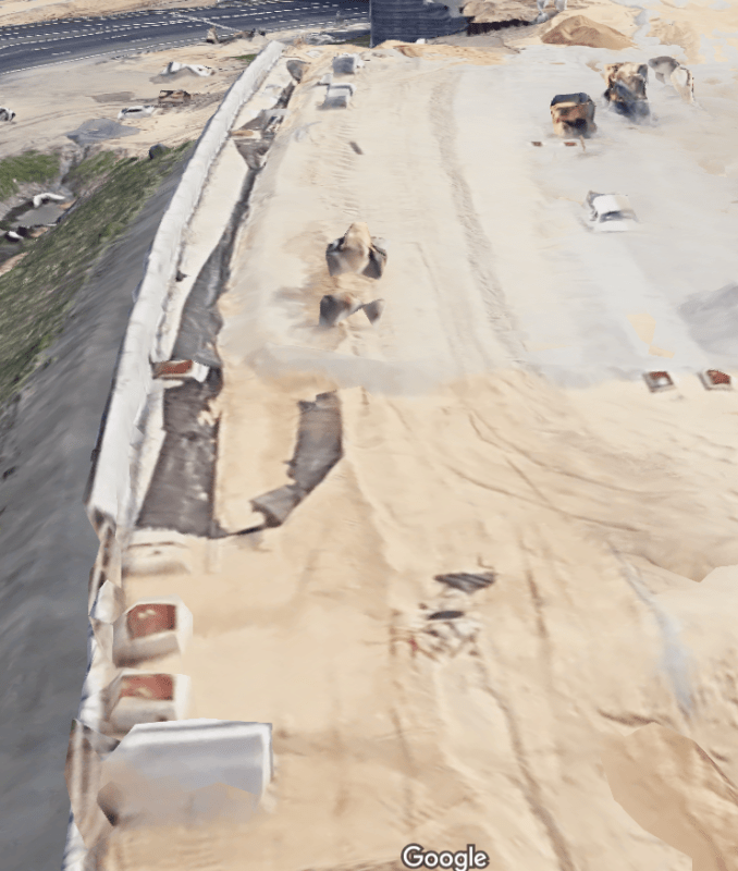

Google maps link: Link Enable "globe view" for an interesting look at the pre-collapse construction.
Looks like that area has been worked over a few times.

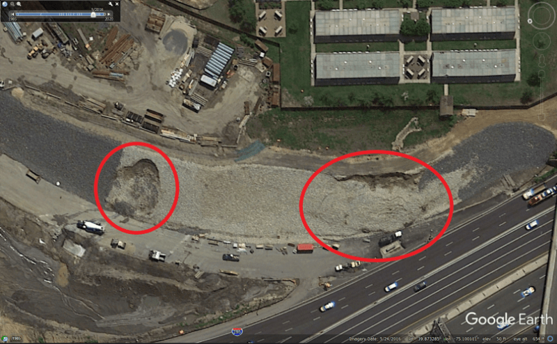

Coincidentally this aerial from 2016 has two slope failures where the wall ended up being constructed.
Tough site, and they didn't figure it out.
