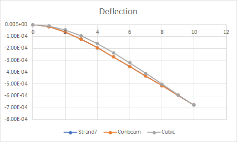

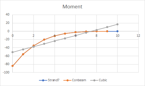

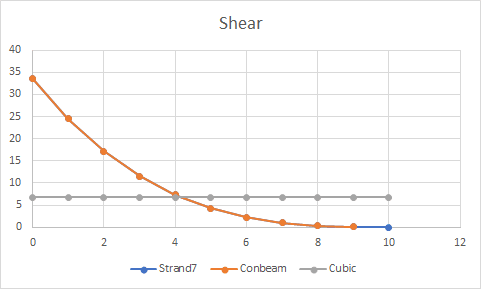

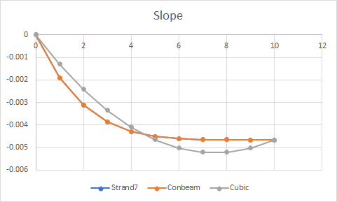

For the analysis the loads along the beam are converted to the loads that would be generated at the ends if both ends were fully fixed.
One way to do that is to calculate the deflection and slope at End 2 if the beam was fully fixed at End 1 only, using standard beam theory. Then calculate the moment and shear force required at End 2 to return it to its original position.
Clearly if the structure being analysed is a cantilever fixed at end 1, then application of the calculated moment and shear at End 2 will deflect the end to exactly the same deflection and slope as if the distributed load was applied to the beam, because that is the deflection the loads were based on.
If the end actions were used to calculate the forces and deflections along the length of the beam then clearly these would be very different from the actual loading, but that is not how the software works, at least for any software I have used. Having found the end actions, the shear forces, moments, curvatures, slopes and deflections are found using standard beam theory with the actual applied loading.
A simple example is shown below, for a 10 m cantilever, fixed at the left, with a quadratic distributed load varying from 10 kN/m at the left to 0 at the right, approximated with 10 trapezoidal loads. Each graph has three lines:
1. Output from the FEA program (Strand7)
2. Output from my cantilever spreadsheet using standard beam theory (Conbeam)
3. Calculations based on the end actions, rather than the distributed loads (labelled Cubic)
For all cases the Strand7 and Conbeam results agree to at least 10 SF. The end deflection and slope for the end action analysis also agrees near exactly.
