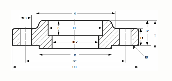

The issue here is in part if anyone supplies anything more than a STD thickness SW flange, but also why would you bother?
A SW flange is as below.
So the ID 2 is basically the ID of a STD thickness pipe.
What happens if its a thinner pipe? A very small ridge which is irrelevant in terms of pressure drop and I wouldn't be pigging through one of these.
A thicker pipe? There is a small depression, again should be negligible impact, especially for the smaller sizes where SW is ore commonly used.
This is not part of the pressure containing calculation and is just part of the Raised Face.
So you CAN specify the wt / schedule of the connecting pipe for SW flanges, but unlike WN, this would seem to be not a requirement and you might find difficulty or delay or extra cost in obtaining something seen as not standard for little to no benefit. All IMHO of course.
