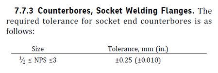

I think this is the section you are looking for.
7.7.3 is tolerance for dimension B,while the question is about D. I didn’t find any requirement in the standard.

Socket depth is usually given as a minimum. No tolerance.
